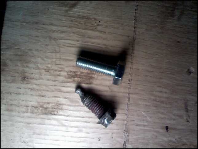

    well 3 out of 4 are able to be lossened, always a stubborn one. used all i could think of save heating the freaking thing or cutting it off. But just for general FYI the bolts that connect the DP to the resonator are M10x1.50. i bought some just up at Advance Auto and im sure they'd be at whatever your local auto parts store is. An inch long bolt will probably work, but i went with 30mm (about and inch and 1/4)
    The old one compared to the new one. god bless winter weather and road salt. and only 36k miles on her. i cannot wait till my brake lines rust through...
