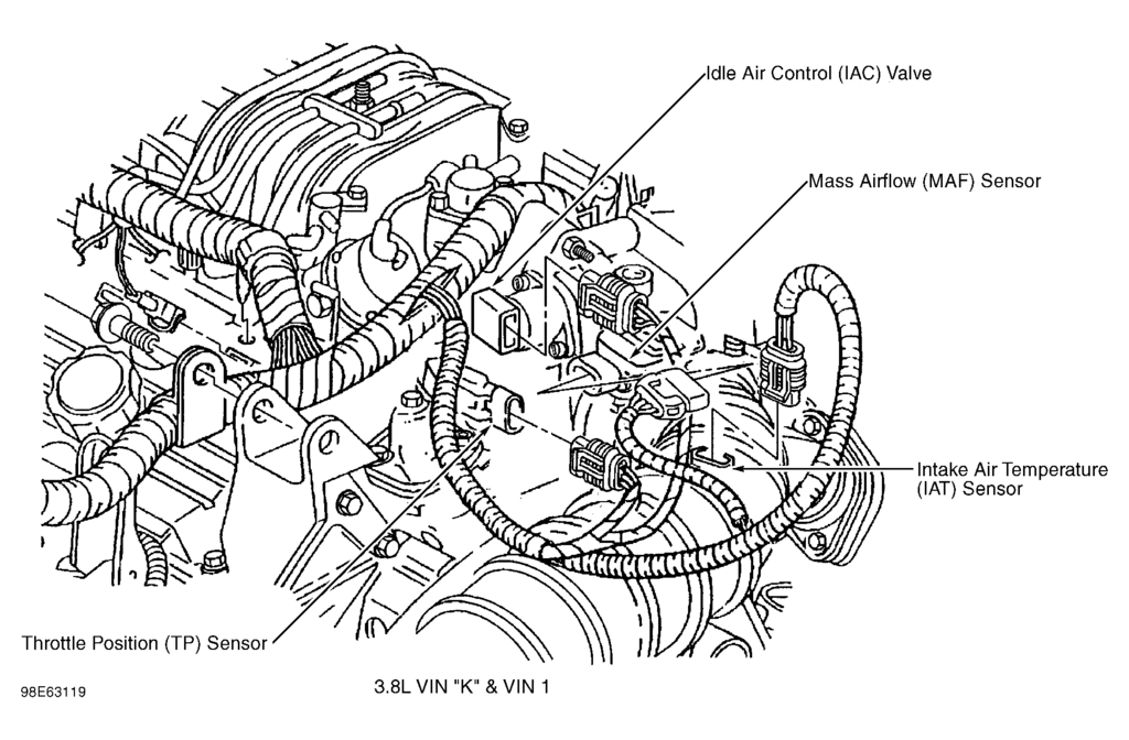

wait a minute.. isn't the IAC connected to the MAF or close to it? I think I checked it already and it does spring out.
So I guess that cancels that
Just a shot in the dark but I know you said you replaced the fuel pump and filter but is there a way you can make sure the injectors are firing? I saw one mentioned to try starting the car with the pedal slightly depressed to see if it stays running. Did it? You said the spark was good so Im still stuck on the fuel theory. Good luck.
i hope this diagram helps you locate the IAC. though you should be getting a CEL with code P0506 or P0507 if there is an issue with it. 506 is IAC system rpm low and 507 is IAC system rpm high.
http://i11.photobucket.com/albums/a178/kingmalm/iac.gif
