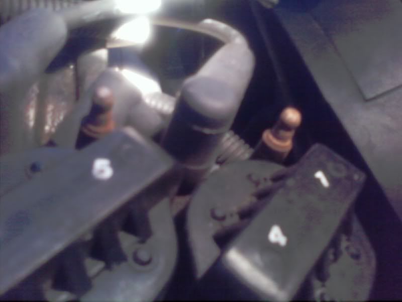

    So yesterday on my way to work my car like hick up'd so to speak when I got on it merging on the freeway, then was fine. Now today I was just cruisin around witht a friend and it started missing under load and boost like anything more then say 80% throttle, and is doing in every time now. Whats goin on here? Plug wires are tight on the coils, and on the plugs seem to be tight too. Mods are in sig, car only has 60K on it. It's a 99.

    ummm whats it mean when 2 of the coil packs have rust all over one of the things the plug wire attaches too?

    not sure what could be going on here, but to start if you have a multimeter, check the resistance of the plug wires, and the resistance from one post to the other on the 3 coils and compare them (as in one coil at a time, both posts on that same coil). If you get wacky numbers between coils, and/or wires, you prob. need to start replacing parts. Prob. ought to change the wires out unless there a good brand, and new within the last half year or so just to rule that out.

    I'd say start cheap first...if need be I have a set of coils you can buy from me off of my car and they have 40K on them. I'd do plugs and wires...if that doesn't fix it then coils. You can try sanding down the rust on that coil pack though...worked for a few people around here...
    Coils a known culprit on these cars? I was eonderin how the hell they got rust on them. So other ppl had this problem and it was the coils?? What are urs off of and how much just incase?

    i'n not to sure about coils being an common culprit, but i have rust on my coils no clue how it got there but just sanded them down and haven't had any problems since.. you may want to give that a try first and then move on from there
    Yeah thats what im gonna do....runs aint a very good conductor lol What should I usr that wont damage the tip?

    you shouldn't damage the tips but i just used some sand paper i forget what grit tho.. i want to say 600 or 800, but also just as a precaution i disconnected the harness that plugs into the coils and then was sure to wipe all the shavings off
    Thanks! Ya know what else is wierd is the 2 that are like that, the plug wire wont "click" when you put it on, just pulls right off no matter how much you push on it putting it on. Also seems like it dont do it until the cars been running a while, I was testing it today after work and the first few times I got on it it was completly fine, then latr after about 5 more miles it started doin it again. Temp guage was at operating temp before I ever got into it the first time. Why would this be??

    If the plug wire won't click then it is the plug wire...not the coil...but I'd get new wires IMO...and sand down all the rusted coils.

    Went and got some auto zone wires, duralast i think they were, lifetime warranty. chaqnged out the front 3 along with replaced 3 front plugs with some stock range ngk copper core ones. also took some sand paper to the coil posts and got them looking alot better. Seems to have fixed the issue. I'll be putting the other wires on and changing the rear plugs next month when I order my pulley and pcm. Thanks for the help everybody.
