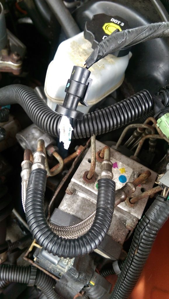

You aren't getting fuel due to the pissed off connection issue.
Pull the connectors off teh pcm and look for any wiring that is pulled back from moving the harness around during the swap. Also ensure the ICM is properly connected and that no pins pushed backward, then check the connector right by the FPR to ensure no wires pushed back out.
Those are the three points where wiring could be an issue, unless someone beat the engine harness up while swapping motors.

Also where's the fpr on the 2004 engine?
Re: Car just cranking and not starting after Engine install.
Look straight down from there.. You'll see a piece on the aluminum AC line that'll match up to the other half of that.
04.. no fpr. so that connector will be right by the #1 injector. Has like 8 pins in it.

Ok fpr connection is tight, checking the I'm now
Don't just check for tight. Check for pins pushed out. Wiggle the harness where it goes from whereever to the engine.
Uh.. hey... 04. Did he pull the connector at the fuse box to pull the engine? If so.. it's good to check that bolt too
