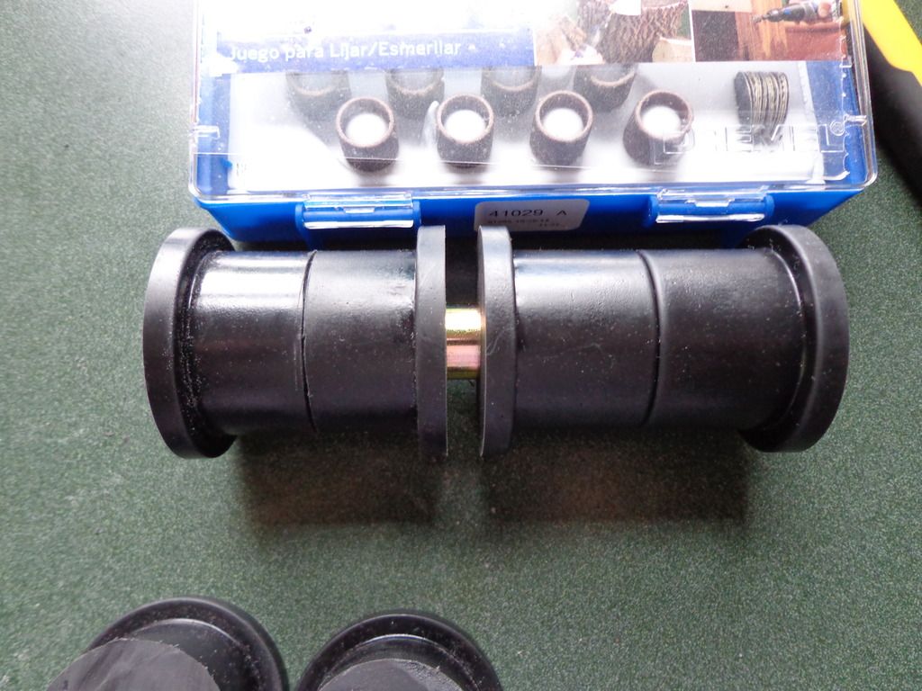

Booba- be careful cutting those! Will you grind or cut, hot knife, or whut? I've used vegetable oil and a serrated knife to cut right through big rubber bump stops but the poly may not be that soft. FWIW, good idea on the polys for the arms, what bushings did you order for that?

Energy 3.2125G's I need to cut them both down and use 1 stock sleeve, but that'll be it. I hope to use one of the Energy sleeves (since I'll have 2 extras) to hold the bushing while I hit it with a Dremel with a cut off blade. I'll have the sleeve sticking out the shoulder side quite a bit so I'll have plenty to hold on to.

Well I have the larger of the 2 bushing done on the trailing arms. It's actually pretty easy, just smells like ****:
