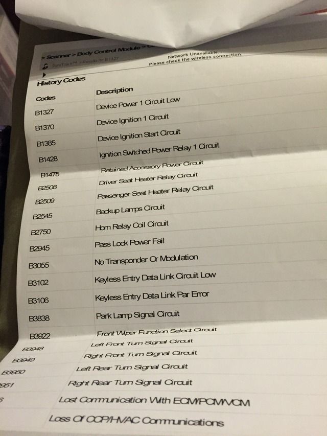

Yup lol.. Been having issues with it random shutting off on me.. No cel no nothing.. Rpms dropped almost pointing to the symptoms of a bad cps...swapped that. Same crap. My scanner wasn't picking up anything and it had the basic spark, fuel, etc. dropped it off at the local shop and had them scan the bcm and that's what came up.. They're almost thinking it's the ignition switch and there's a recall for it if I'm not mistaken. Of course car ran fine for them and didn't shut off on em. I'll take it to the local gm dealer in the morning and let them do their recall work.
The "recall" for 04+ does not replace the ignition switch. It doesn't replace anything, they just put a piece on the head of the key to keep the keyring centered.
Re: What did you do to your Car today? Vol 2.0
Yea that's whts I figured and heard but Ima take it down there tomorrow just to check.. If all else fails I'll swap the ignition switch again and go from there.
