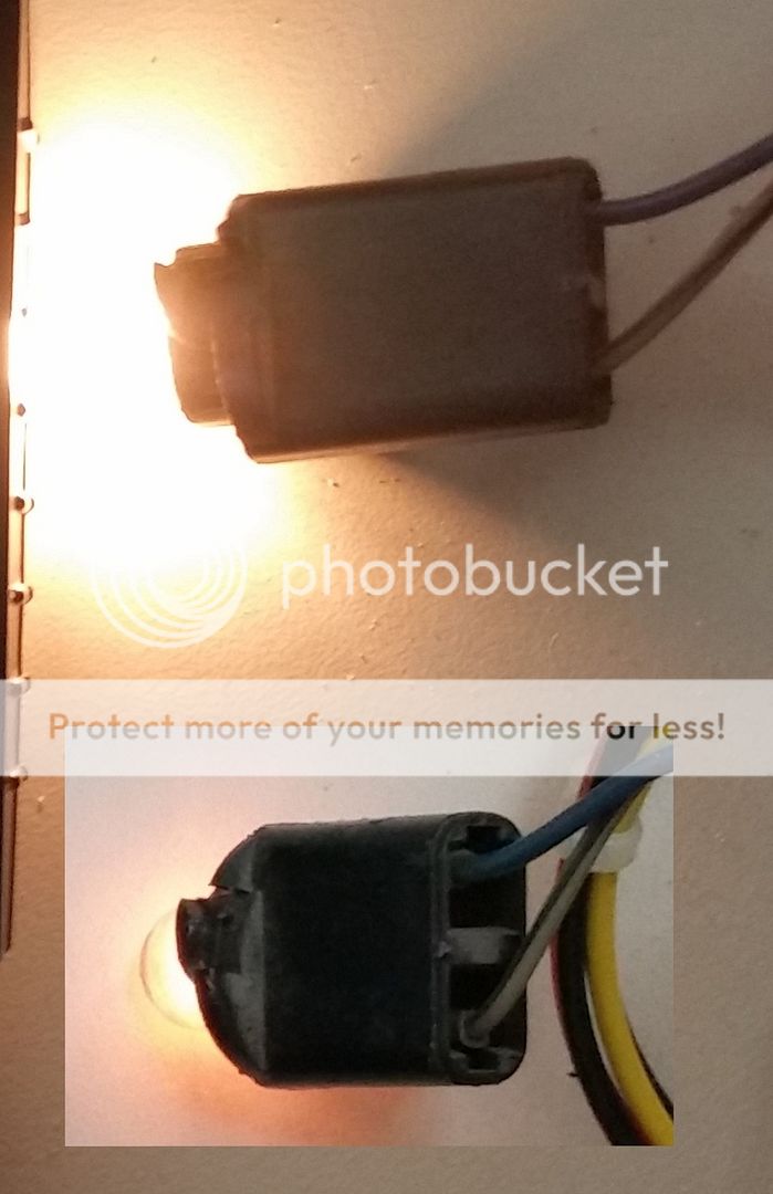

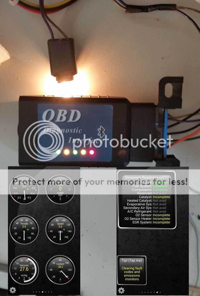

    Success!!!!
    Well the coolant temperature looks like we are in in ADecker's state, 27" of vacuum, but hey there is some green. :-) Now can I manipulate the sensors with the Pi to fake some reading.
    The coolant may be a good one to start with.

    First, thanks Scottydoggs. Your post http://www.grandprixforums.net/threa...=1#post1270142 got me off in the right direction.
    Clue as to what it is, look at the bulb on top and the one on bottom. When I got the "hello world" light, to light up I thought it was kind of dim. Guess why, yep I was using the 5v wire. :-(
