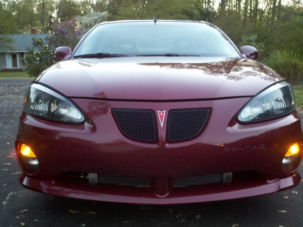

I hate your face for having that. I need one now.
