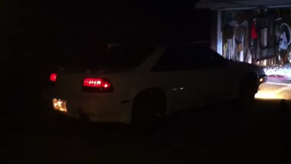

Recorded this video of the engine
http://youtu.be/uoCX4SmdsZ8
WHY?
so i know there is a wobble like noise in there too... but the other noise is what im worried about...
Snout or needle bearings mines making same noise, remove the belt and the noise will go away. Time for a new charger.

this is without any belts.
http://youtu.be/RF-VFy80fxU

take a vid with a quick throttle snap, gas it and let off the gas fast. then one of you holding the throttle at say 2,000 -2500 rpms for about 5 seconds, then just let the gas go. aka let off it completely.
dont matter since it makes the noise with or with out them.
im trying to hear if its the bottom end or the valves, broken spring, if it goes away it could be a flex plate.
any milk shake or glitter on the dip stick?
