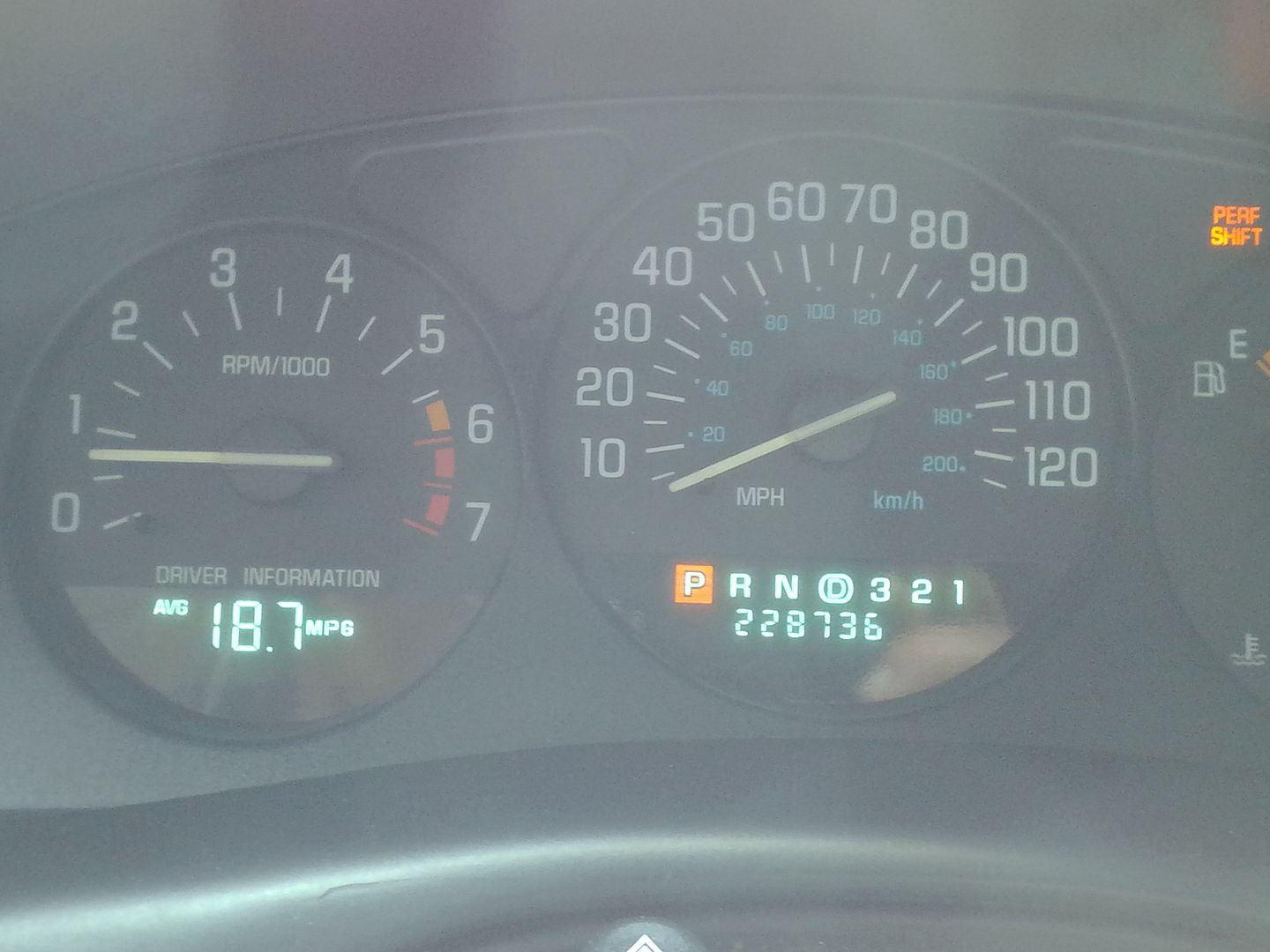

installed anew up stream o2 sensor. and ill be damned looks like mpg are holding at 18 to 19 local even with beating on it some. also it seems to have killed a lot of KR. i was seeing 7.8 nailing it and now the most i saw today was 2.7 and at part throttle where i had up 2.8 i was seeing only 10's of degree. 0.4 and 5.
and the car feels smoother under acceleration and maybe a bit more responsive too. cant wait to see what a good highway drive will get the mpg up to.

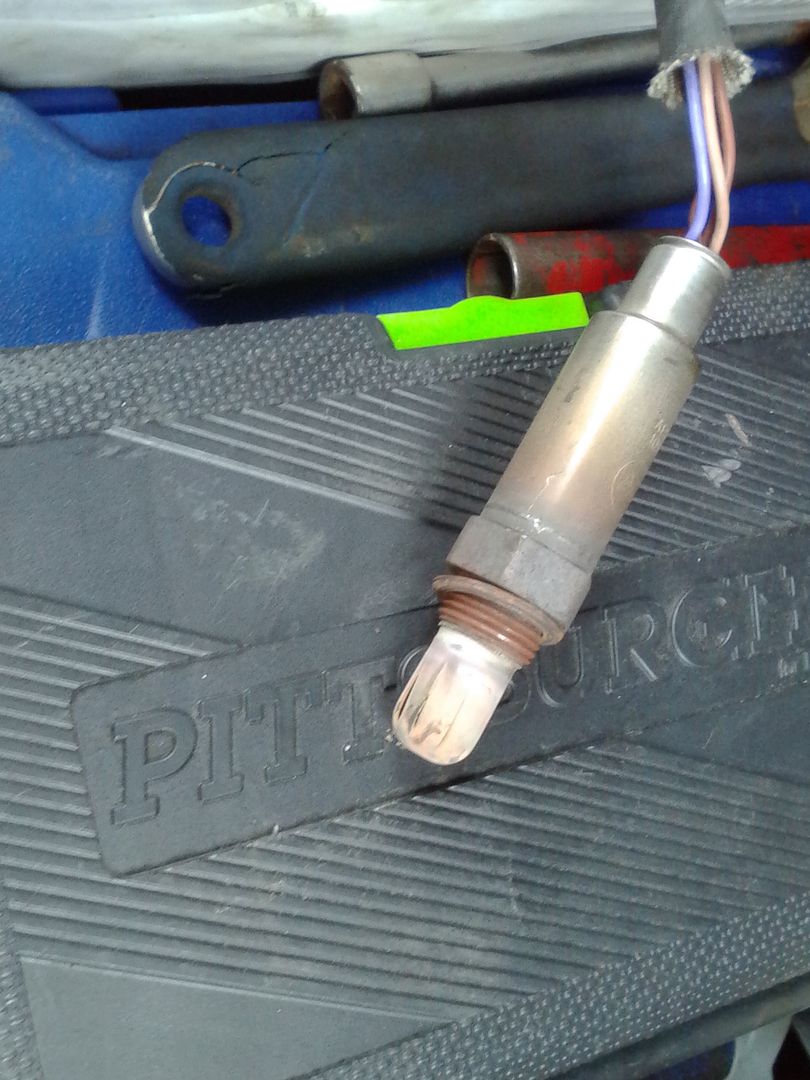

old crispy o2. when i shook it it had a rattle sound inside, new one did not. didnt check the old one brand but the tip is different then the acdelco i just put in.
