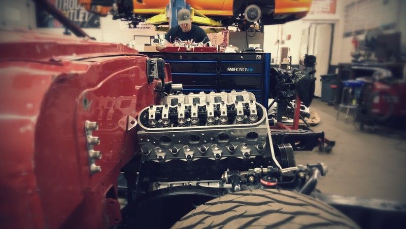

1969 Camaro Twin Turbo in Progress

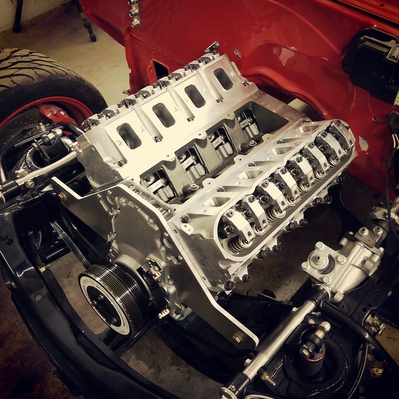

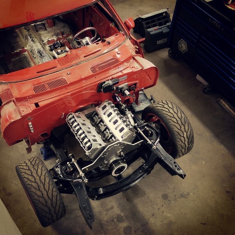

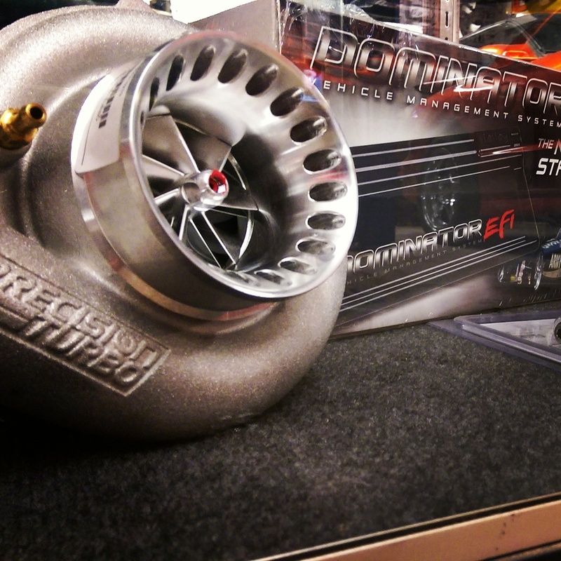

Really cool project we are putting together with some top notch parts. Dart LS Next block, Best of the Best 427 rotating assembly, 6 bolt LSx Heads, Twin Gen2 6870 Billet Precisons, Jakes Level 5 4L80e etc etc. This is a crazy in depth project. Shooting to make 1500-1800whp. Still needs a LOT of work, but we chip away a little every day.

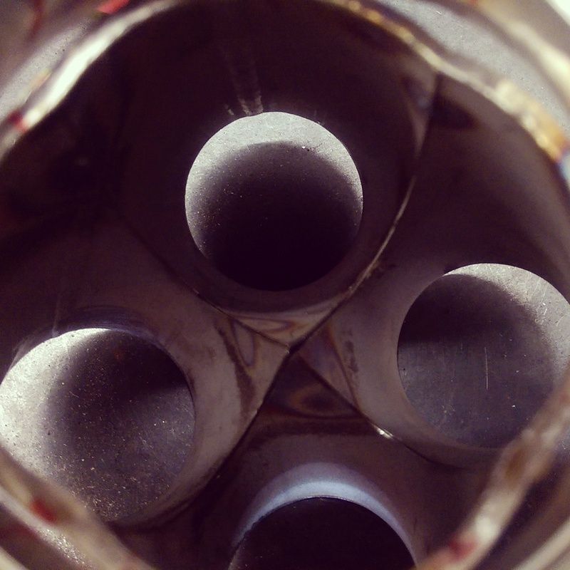

-CNC Exhaust Flanges I designed for the quarter panel exit. Most likely will get blacked out with a little trim ring around them.

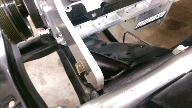

-Furches Performance Motor Plates; No Mounts (front & mid). Motor is dropped down and set back. 3* driveline angle.

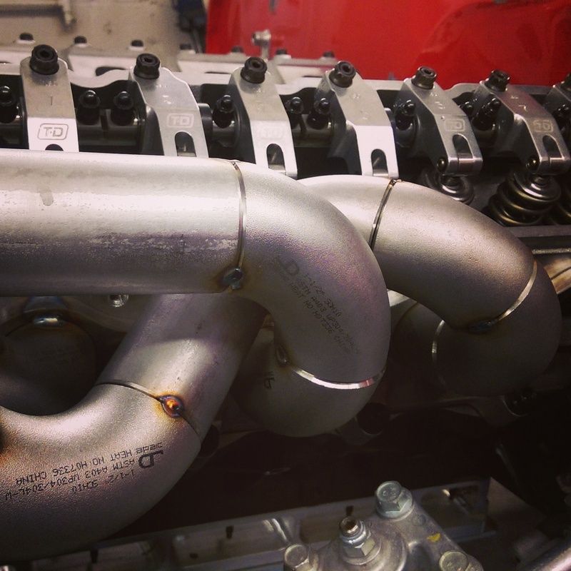

-Schedule 10 304 Stainless Turbo manifolds In Progress
-Cage Work. Stopped after the main and Halo because the interior and exterior are getting a color change before we strike any arcs on the floor plates.
