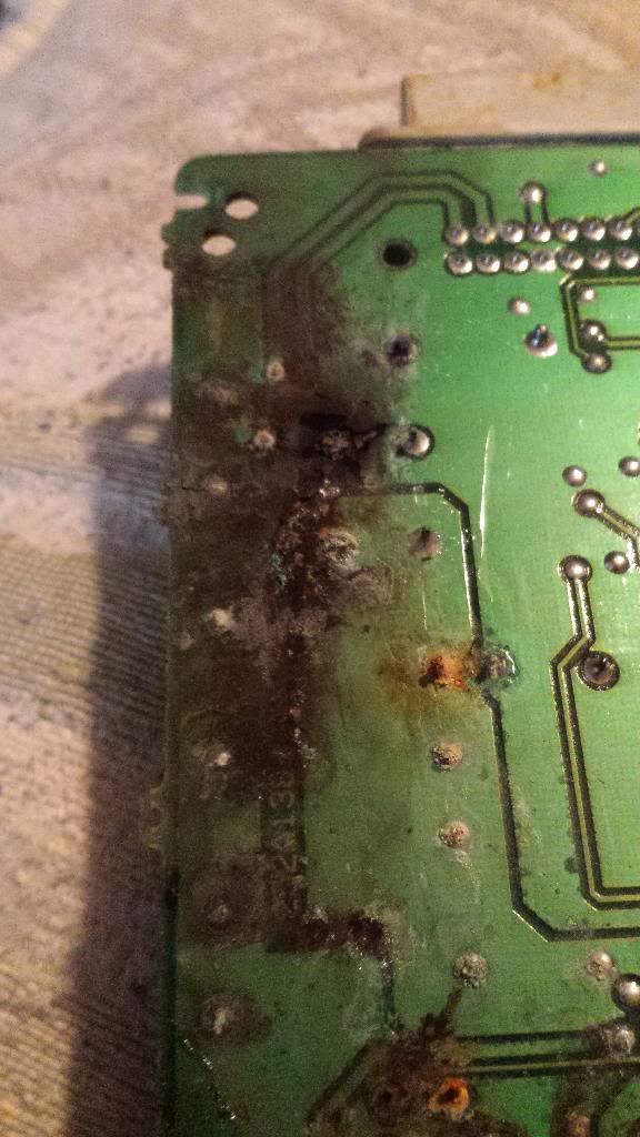

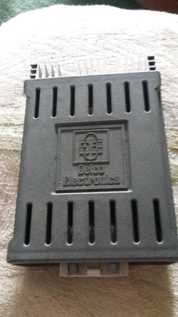

Slick2500 you were right I found the amp it has rust on it http://i1121.photobucket.com/albums/...psjyuufyqt.jpg

http://i1121.photobucket.com/albums/...pscxjwxman.jpg
