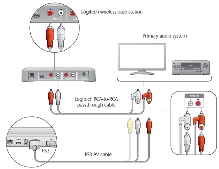

    Best cable ever.

    I'm lost.
    Why would you buy another device when you can just buy a cheap cable?
