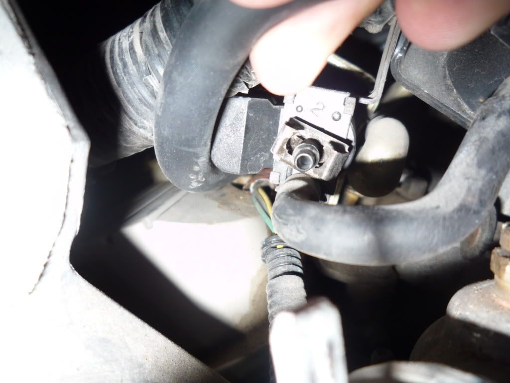

on the right side of bbv, theres a open port too. it came with a foam filter on it, but most have fallen off by now, so if thats open its normal.
Does it matter which side the vac line is hooked up to on the BBV?
On the one side of the boost bypass solenoid, you should have a vac line hooked up to one of the nozzles, and the foam in the other. Does it matter which side the foam is in vs the vac line? (Mine has three total nozzles on the BB solenoid) if that still doesn't make sense I'll try to get a picture ASAP
the one that would of had the foam filter on it has a odd looking metal clip there. that one stays open.
found a pic, this should be open
http://i966.photobucket.com/albums/a...y123/017-1.jpg
Alright, I'll check and see if mine is hooked up correctly.
