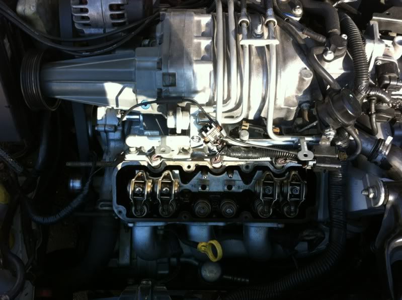

Just did what you mentioned and I still hear air comming out of my supercharger :/

while you have the air on and its leaking, hit the top of the valve with a rubber mallet, it should seal up.

How will that seal up? Wouldn't it cause it to open more when I hit it?
Re: L67 Engine Swap and Cam Decisions.
for the slight second, yes. it might also jiggle it back into place and seal..

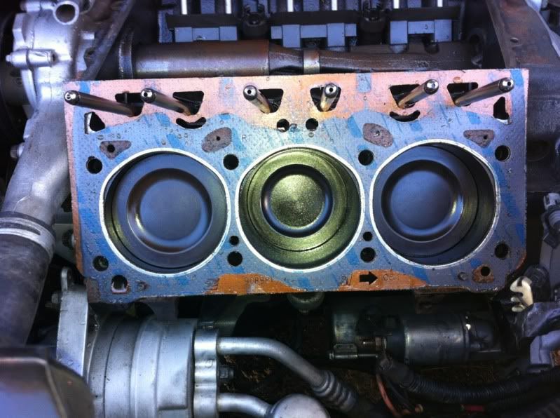

Ok did what you suggested and still nothing for tired of dealing with that so I took the head off pistons seem fine.

also did I put my head gasket on backwards? I say this because of the arrow.

hm, well that's a good sign that the pistons are good.
and yeah, typically the arrow points towards the front of the motor (passenger side).
HG is on wrong.
The small hole goes on the waterpump side. (look at it long enough and you will know what I mean).
You are going to also want to have the heads done... you either have some super busted heads, cracked seats, or bent valves.
Yeah but you can't flip these gaskets. They are felpro the rear head gasket was on fine. I guess when I bought them they gave two the same. But over all there is no issue at all with that.
I saw many videos on how to check for leaks on the heads. Found plenty, so what I did was flipped the head over rockers facing down and added gas or water on to the valves. Sure enough 3 and 4 that had 0 compression were leaking a good amount the rest leaked very little sometimes nothing but I think I should get them all done but idk how much it would be or if I should just buy some heads of the forums? Usually 100-200 for fresh ones any thoughts? I am just tired but glad that I found the issue well don't wanna jinx myself till its all put back together and running great.

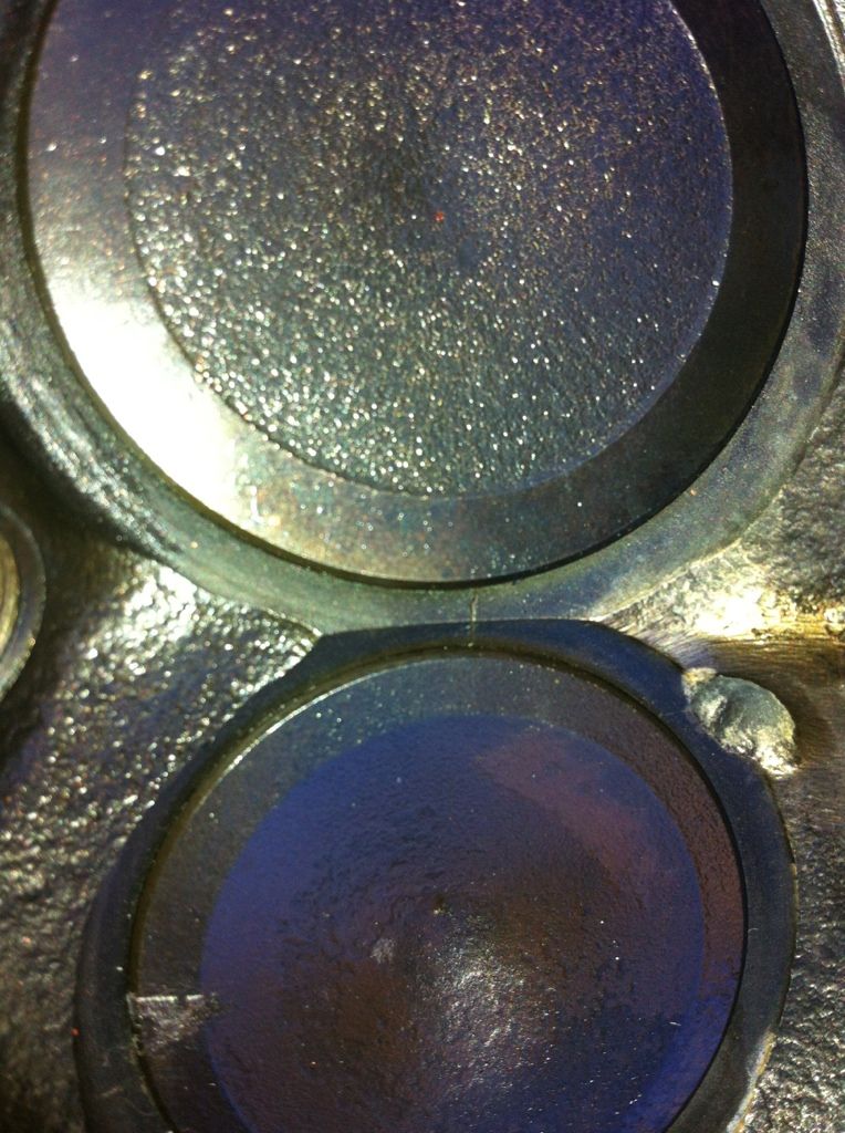

Also found this on all cylinders on the heads.
http://i72.photobucket.com/albums/i1...569C50F859.jpg
small crack in between the two valves.

Those cracks are really bad looking... usually nearly invisible ones are enough to junk a head by most engine guy's standards.

Find it weird because they didn't have that when I installed them only the chip it has next to the valve. Going to be taking them today hopefully it won't be more then 150 for both.
you would spend ALOT more than 150 for new seats, if they would even do them. I would get new heads.
