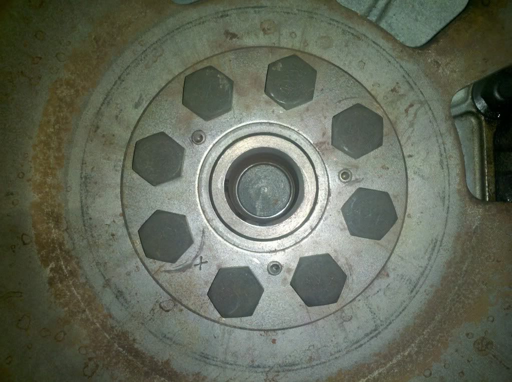

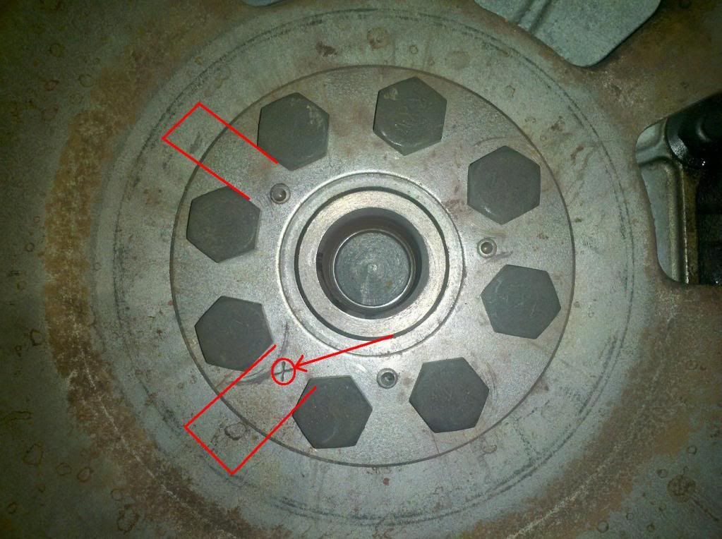

    The bolt pattern is not symmetrical. You can't tell by just looking at it.
  13. #33 Re: drive plate weight
    GTP Level Member Rico's Avatar
    Apr 2009
    Fort Worth TX
    1,721
    See it now? This is the L36 I just replaced in my daily driver.

    okay i see it now. thanks for the pic rico. looking at it at the angle i was made it look symmetrical
