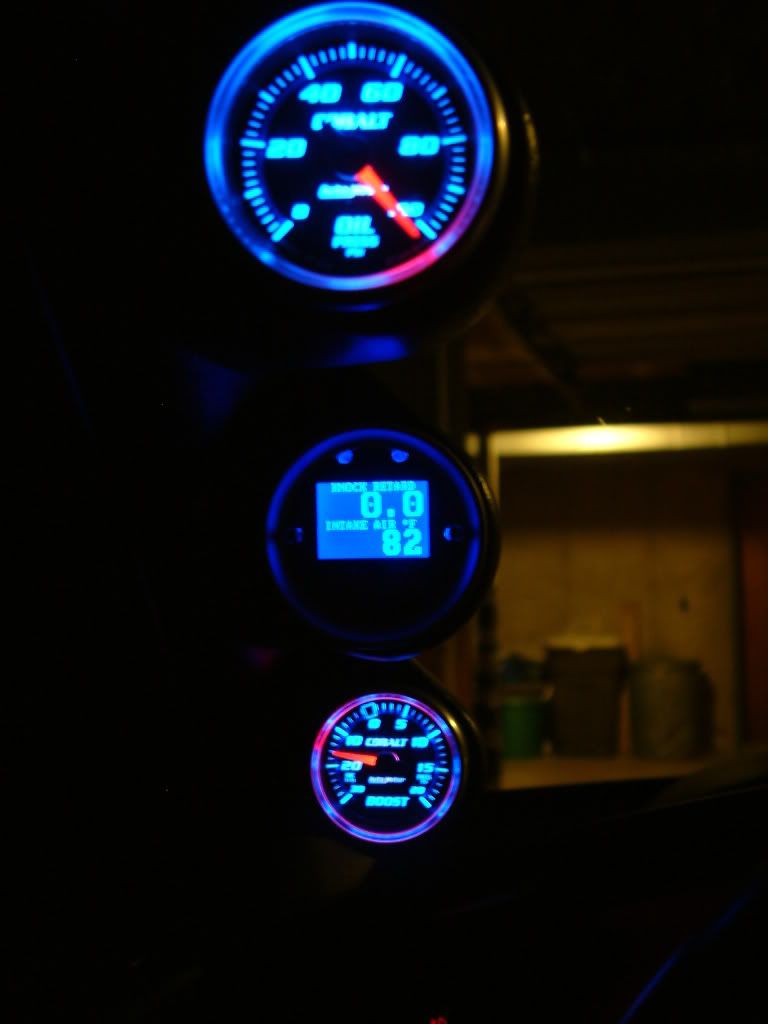

    Well I bought 2 more Gauges today ProSport Boost and Oil Preesure and Ordered the 3 Pillar Gauge Pod I can not wait to get them hopefully this week if possible. I want to put them in real bad

    this is what I am planning on doing as well. I ordered a boost gauge and Oil Pressure from Prosport I can not wait to get them in I ordered the Pillar 3 Gauge pod too. I am not sure what gauges I want to put in to the spot that you have your AF and Trans temp I was thinking Transtemp and Something eles. What is good about monitoring your AF

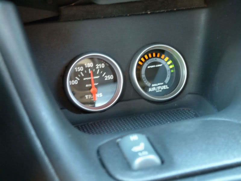

    Did you ever get the wideband sensor installed or does the gauge still go nuts when the car is running?
    EDIT: Looks like it's working..I can't tell, but does that AF gauge show any real numbers or is it just a relative range?

    Well the A/F LED gauge is basically useless. But the Aeroforce's A/F Millivolts reader is pretty darn spot on. It mirrors the LEDs pretty well, but gives a better number value to what the LEDs try to show. And no I have not gotten a WB A/F yet, though I am diggin' Rick Cobalt WB A/F setup
