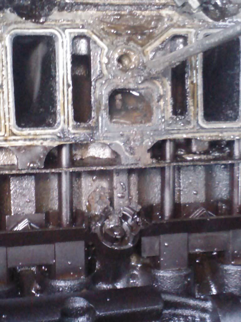

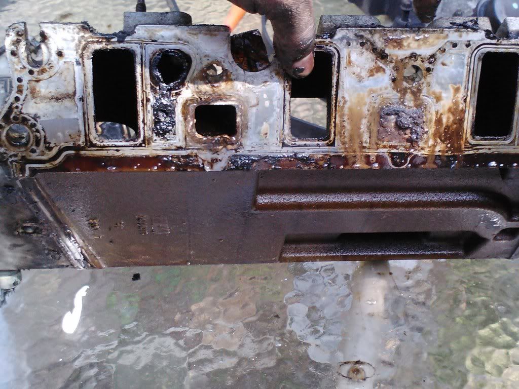

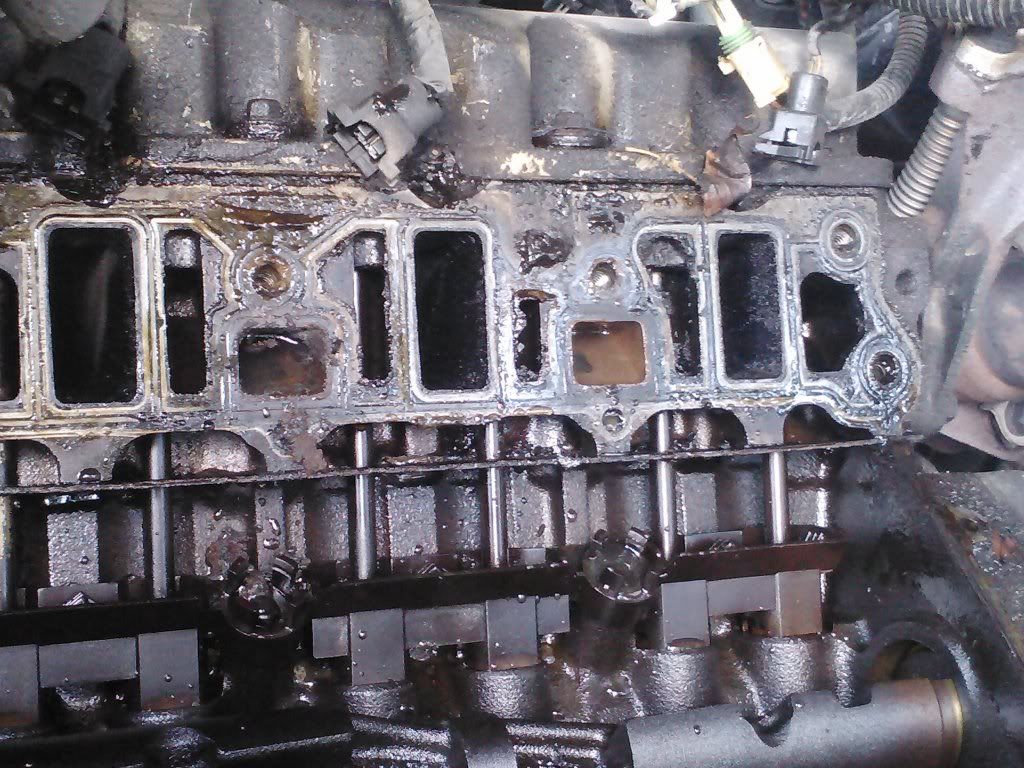

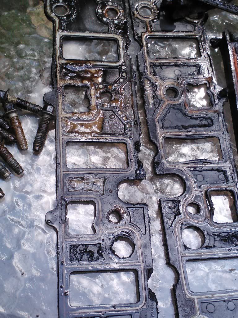

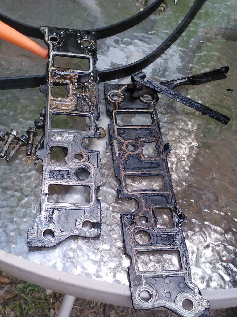

well lims off.... heres some pixx

Typical plastic LIM gasket job.........
thats looks nasty i thought you said the lim gaskets where replaced before you bought the car. those look like same ones(much much worse) i had on my car when you helped do mine. That oil cap looks like a burnt cheese pizza
oh gross! looks like someone threw up on your gaskets lol. typical though. theres your culprit.
I'll bet it doesn't overheat anymore lol
i kno jay dee i thought they were but i guess they lied... cop i figured but dam so soon.. i had the car maybe two months today.... smuts i bet it dont lmao.. and i hope so mclovin..
Looks a little bit worse than normal. Well Done!
the entire lim down was gooie as hell
