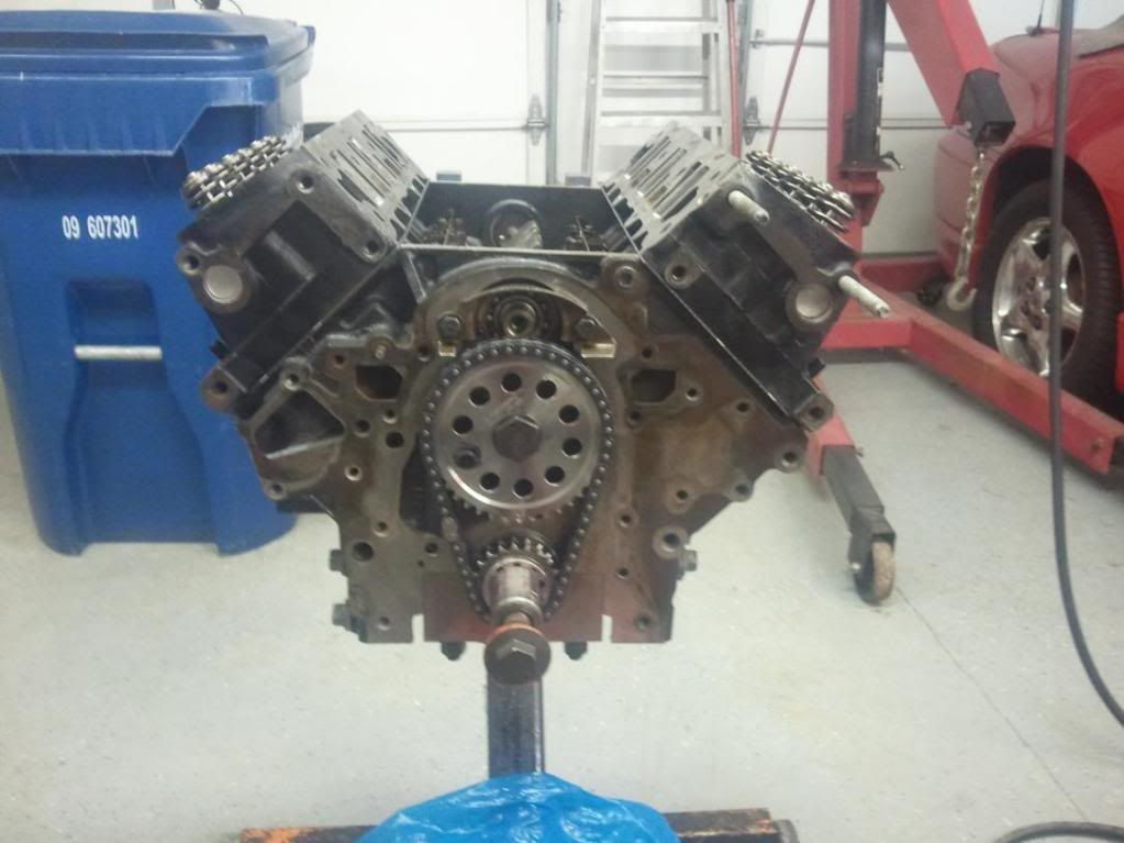

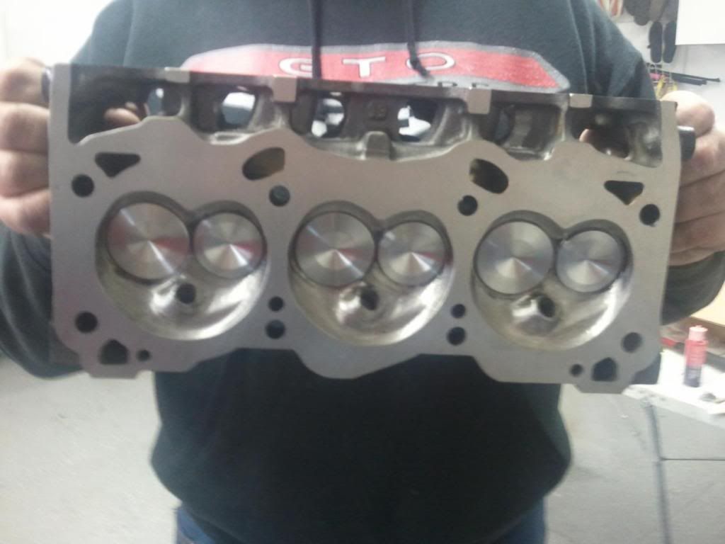

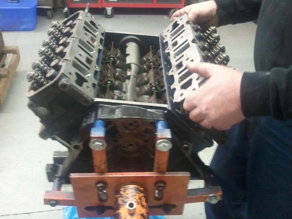

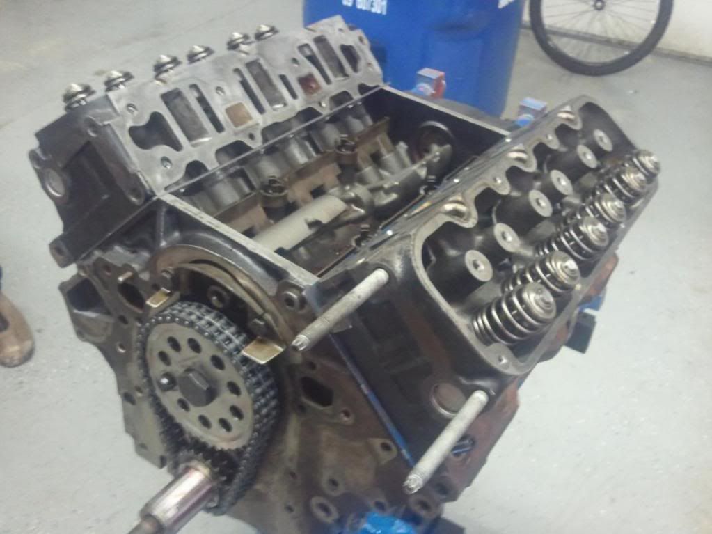

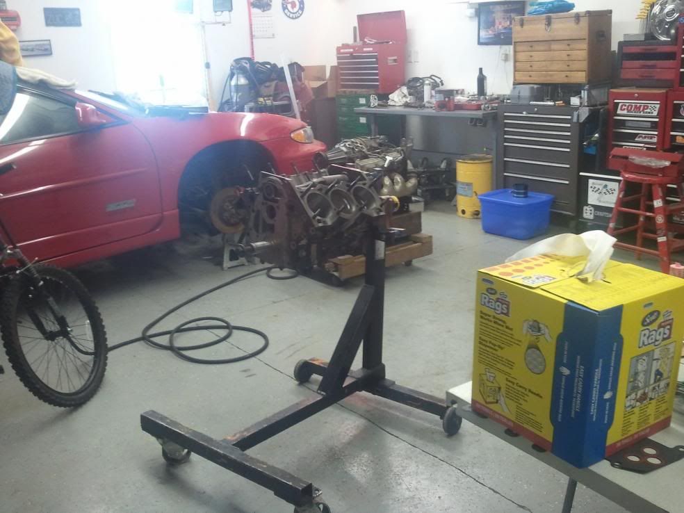

Bizarre I can see them here but no one else can? I copied them from our local forum, I did'nt take the pics, stlmo_gtp did so they are'nt in my photobucket. Yep, fail on my part lol. I'll take some more soon.

no pictures of the valve seats and the porting? boooooooooo
Boo, I agree.
UPS delivers.
Page 4 for pics of the porting. Sorry no pics of the finished valve seats (smacks forehead).

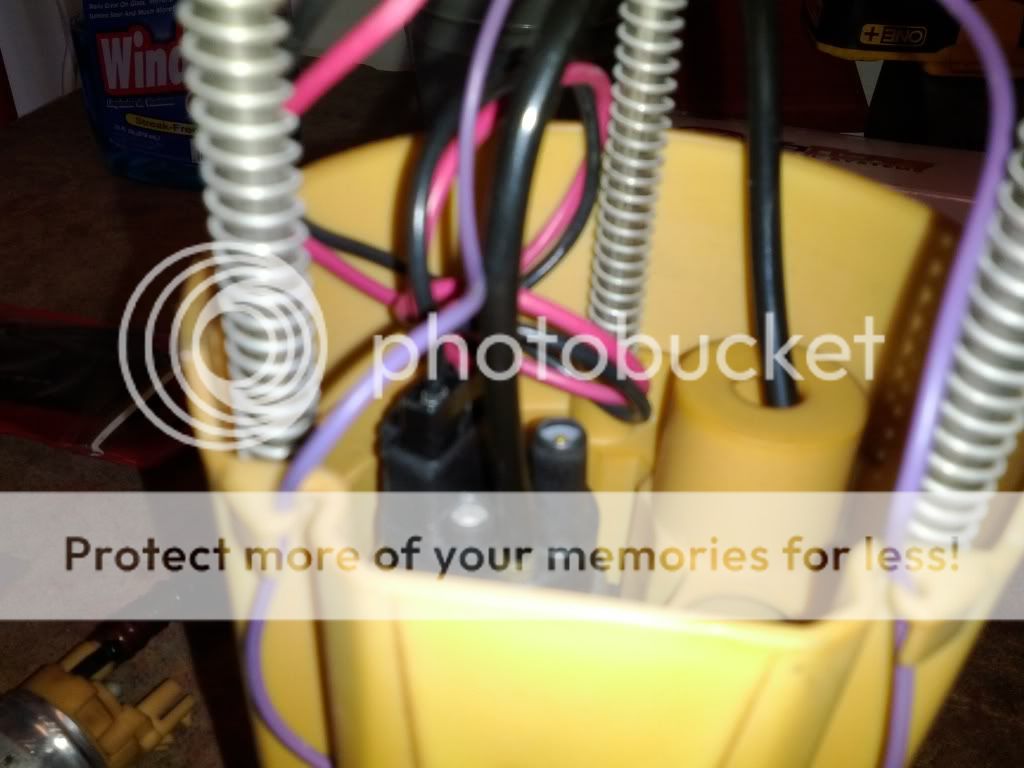

One snag is the fuel pump I ordered from TRE is different from the on in the car. My Airtex replacement pump has two inlets at the bottom and the TRE pump has only one. Also the TRE pump has a very small brass fitting on the top on the pump that mine does'nt have. Not having my factory setup I'm wondering if the Airtex is different than the factory unit and maybe I need to go to the boneyard to get a complete factory pump/bucket assy. Anyone know? I was going to contact TRE customer service but figured I'd wait to see if anyone here knows.

^ No, it's so different from my stocker (Airtex replacement) that I don't see how to make it work ie. one inlet versus two plus the small fitting on top I'm not sure what to hook that to or if I just leave it, plug it.
Anyone have pics of a "stock" 97 pump? How many "inlets" does it have? The TRE pump says it fits 1997-2000 GTP's. TRE-344 is the part #.
the tre pump you have is venturi.. the airtex replacements fet rid of the venturi tube. do not put the tre pump in unless you have a venturi canister...unfortunately i just sold the canister i had so i cant help you there. if you go to the junkyard, look for all 97-00 gtps or regal gs' and get the canister out of them..youll know it is venturi if you see a small black nylon tube going to that brass nipple.
This is what an upgraded fuel pump should look like with the venturi tube hooked up.
You cannot just plug the fitting. Without the venturi system functional, the pump will live a very very short life.

Looks like I'm on the hunt for the venturi style pump assy then :th_bangheadonwall:. Still can't believe I threw out my original when I replaced it with this overpriced Airtex POS.
Thanks for the help and pics guys :th_beer-toast1:.
