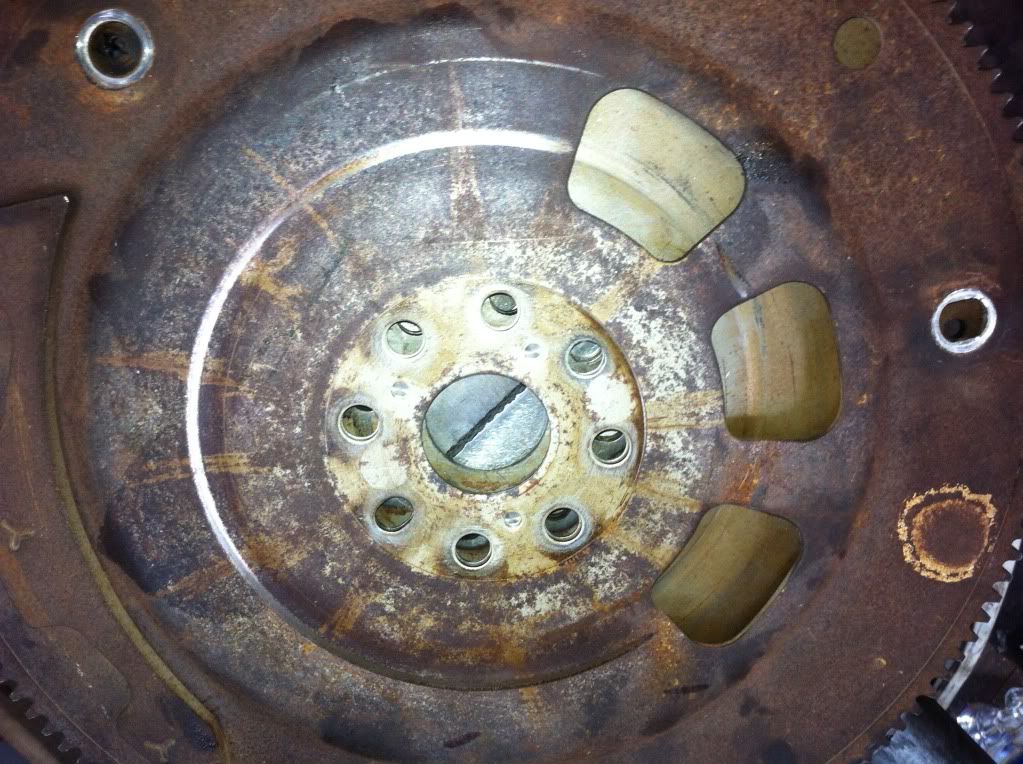

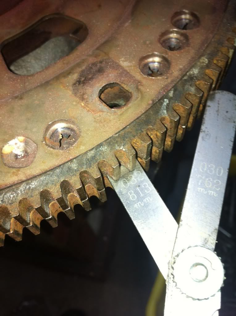

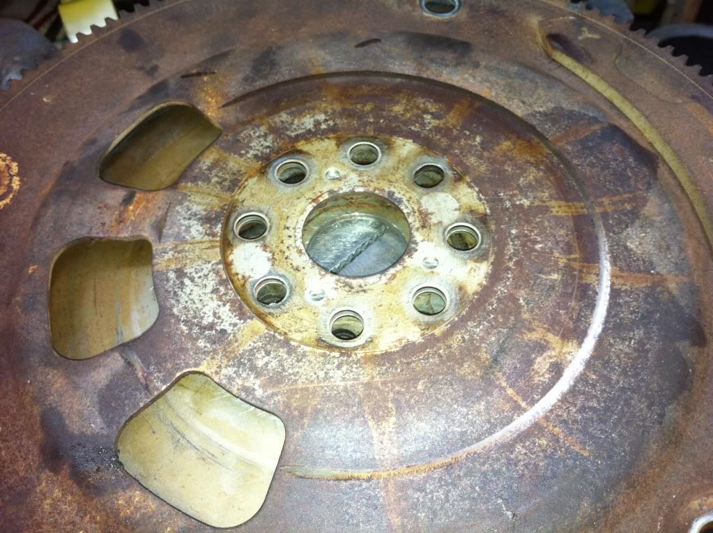

So I pulled the motor sunday, took 3-4 hours taking most all accessories off and helping a guy from the car club change his wheel bearing at the same time. I don't see any cracks whatsoever on this thing but its for sure not flat when laid it on the two good ones I have. But its only like .032 off at the farthest point. It did have a rub mark on the back all the way around but for the life of me I can't tell what it was actually rubbing on the motor...

hmm. just from the pics i can't really see anything just obviously cracked.

I'm gonna wire wheel it next time I'm out in the garage and check closer but there's none that can be seen with a flashlight and my face an inch away from it. Just that little tiny bit of bend in it... May have happened when the junkyard pulled it, during shipping, during install, when I swapped the trans... Who knows, just picked a really really odd time to make itself evident. I'm gonna bolt it back on and see if the starter can spin it fast enough on the stand to make it wobble or hit a bolthead on the motor or something
if you were to tap the flywheel with a hammer, wouldn't it have a different tone if it were cracked? being that you have a known good one to test out side by side.
i dont know this for a fact, but it may just sound different.
Gonna pry on it side to side in the vise too and see what I see... I'll try that hammer/tone thing too and see.

So after cleaning it with a wire wheel on the angle grinder I still saw no cracks whatsoever. Tried hitting it with a hammer and listen for tonal changes and obvious now after doing it the part with the cutouts sounds different than the rest and that's where my cracks would be... Just going to retourque the bolts on the back cover and see if any move too much as in one may have backed out. But on the brighter side I ordered my parts, should be here by the end of the week. I broke the cam magnet pickup somehow and need to find another in short notice if I want to have this engine back in before it gets too cold to work outside if anyone has one??? Here's my parts list, anyone care to add??? And do we still have to machine the crank gear on the double timing sets to get them to align or has this issue been fixed? How beneficial would it be to degree the cam since I have the option to?

Seeing that mark, makes me think rear cover bolt for sure.

I thought for sure too but I see no rub marks on ANY surface anywhere on the back of the motor and with it mounted it looks to be at least an 1/8" away at all times. Here's how bad it looks in rotation though... I had 4 of the bolts back in kinda snug is all but you can sure see it
