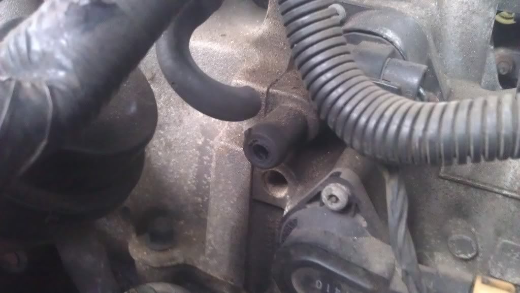

    Can anyone tell me what this is? I'm guessing its important and it is shooting air out. The line is suppose to be connected where the hole is.

    that will cause a massive vacuum leak, hence the car running like crap.

    go pick up some vacuum line and replace it like $5 fix
