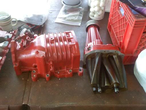

    So i picked up a spare blower off craigslist for cheap and decided to try my hand at porting and polishing it was a realy ugly red.

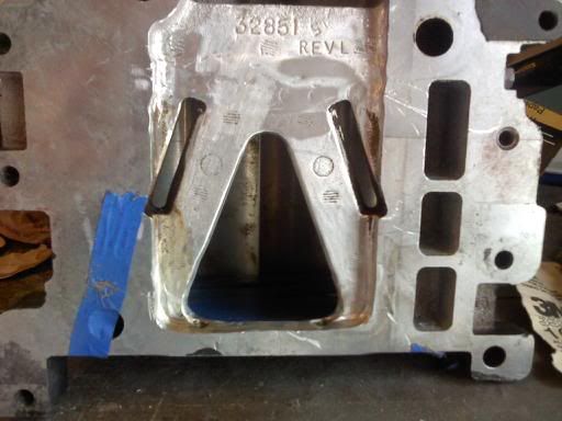

    ported the outlet

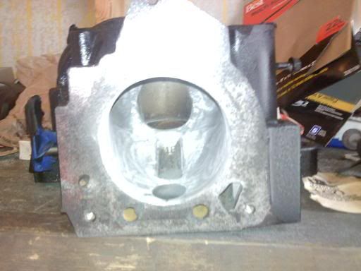

    Smoothed the inlet should i fill in the divot with some jb weld or just leave it? Also im not running egr so im thinking about just plugging that hole as well.

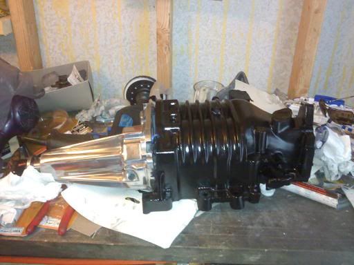

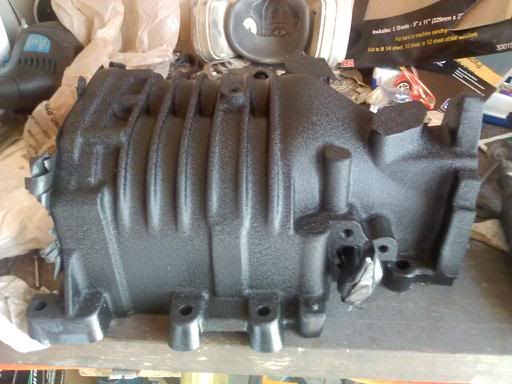

    I decided i hate the red and got some aircraft stripper, removed the red and painted the case with some vht wrinkle black

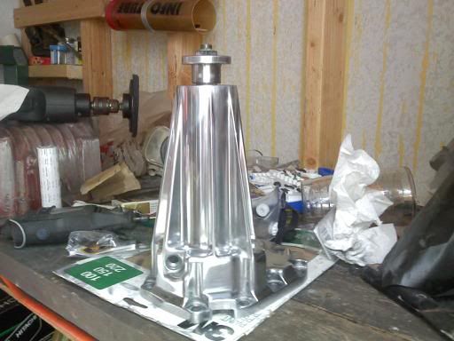

    The aircraft stripper started to pull the coating off the snout so i decided i would just try to polish it.
    mocked up without rotor pack before the paint started to realy wrinkle
    Took longer than i even want to think about and my fingers are still hurting from sanding in between the ribs.

    i like that wrinkle look looks reall good man. and good put on the snout. looks AMAZING for first time

    I am kinda proud i had to post it lol. the aircraft stripper didnt realy pull it all off it just made it look all nasty and i didnt want to put it on the car like that. i did not know at the time that the snout was the hardest part to polish or i might not have done it it literally took forever.

    dude i want my dam snout polished like that. Exactly how did u do it?

    To do this i used a lot of diff stuff
    first i had to get the paint off
    air craft stripper to loosen the paint then got there rest off with sandpaper and flapper wheels.
    Then i had to remove all the major imperfections i used a dremel and dremel tools be carfull dont want to make low spots they are hard to get out later
    dremel
    flapper wheels 80 and 2 120 grain
    2 high speed cutting bits i guess they are
    a bunch of sanding drums
    grinding bit/ looks like its made out of a rock
    wire brushes/ for the corners and groves
    Then once the whole surface was pretty level used sand paper to smooth it out started with 100 then 200 300 wetsand with 400 500 600 1000 1500 2000. i had to go back up to 100 2 times because i didnt get all the scratches out and they realy started to show up when i got to ther higher grits.
    Once i got it level i busted out the polishing compounds started with emerys then tripoli then white rough i used a buffing pad on a high speed drill for what i could easly get to then a buffing pad on the dremel for the corners and use diff pad for each compound the longer u take the better its going to look.
    Wear a mask aluminum dust is pretty bad for you and eye and ear protection wouldn't be a bad idea. also i wouldn't even try it if u are not patient took me forever.
    I got mad respect for reptile for his blower work i donno if i would do another one.

    That looks amazing. And that was really good outlet porting. Love the polished snout

    finally got to see pictures now that im not at work. nice port job. simple and effective, just how it should be. you didnt open up the outlet anymore than you should have and you did a good job. congrats.

    What did you use to port that inlet? Just a dremel?

    yup dremel
