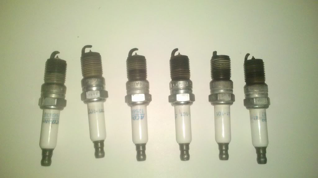

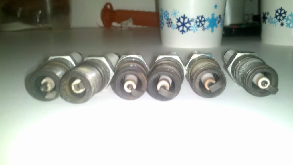

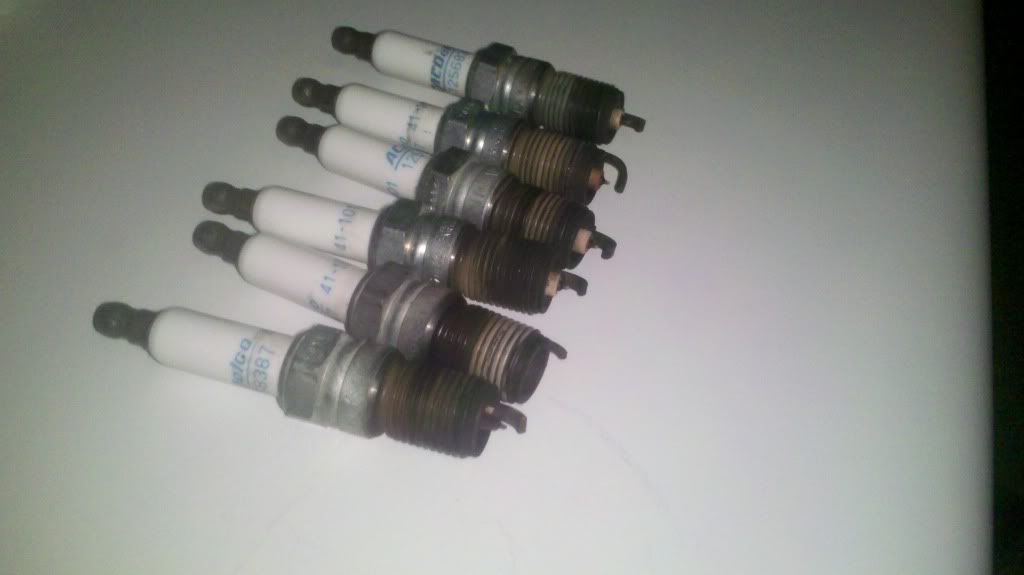

Its started out as a really bad misfire, couldnt figure it out, broke down along the road, got towed into dealership to tell me my spark plug tips are melted and gone. They wanted to bend me over and charge me 330 bucks to change plugs, dont even know why the quoted me. If anyone can help me as to what has caused this and if it will happen i put autolite 605's in now. i had Gm acdelos in. Here are some pics
http://i1187.photobucket.com/albums/...gtp/spark3.jpg
http://i1187.photobucket.com/albums/...gtp/spark2.jpg
http://i1187.photobucket.com/albums/...gtp/Spark1.jpg
http://i1187.photobucket.com/albums/...gtp/spark4.jpg
Update!!!! 2/6/2011
Pulled my egine due to oil coming out manifold, and here i found a chipped pistion on number 5. And all along ive been running with it lol, untill the ring went bad.
