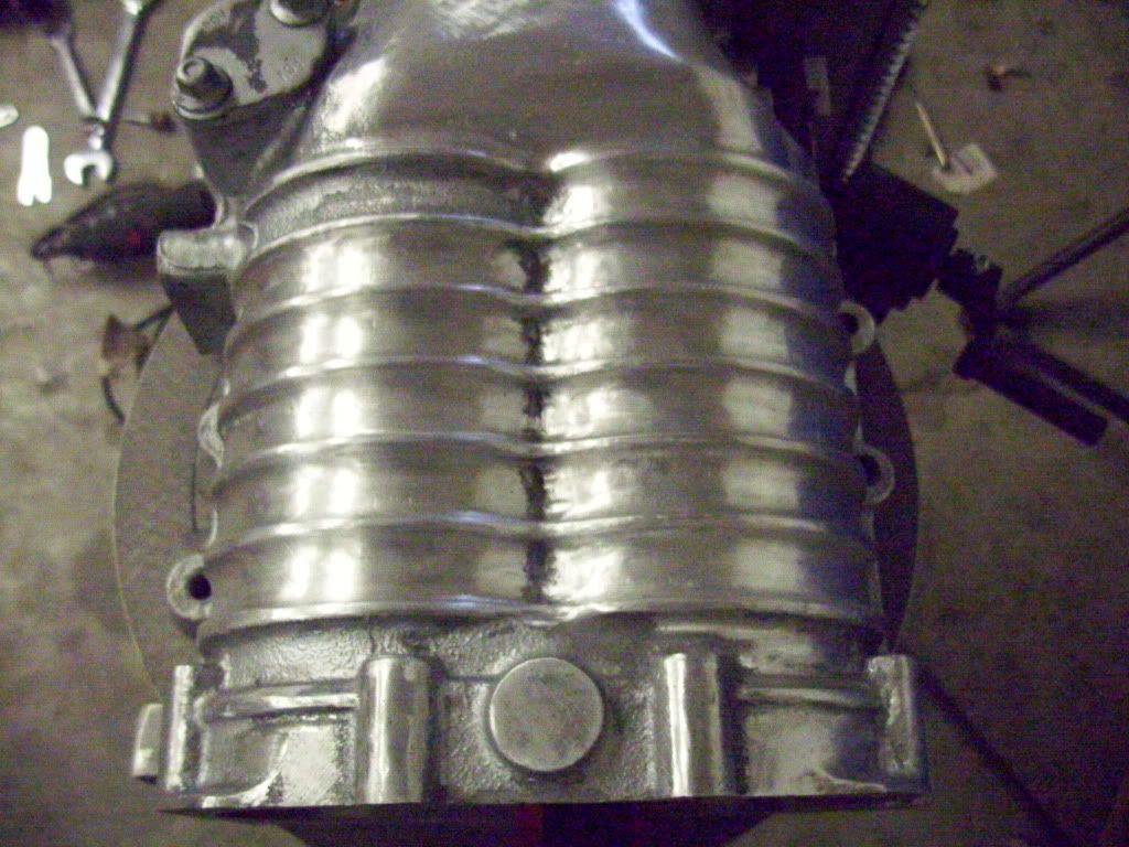

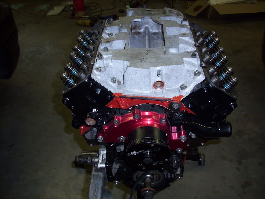

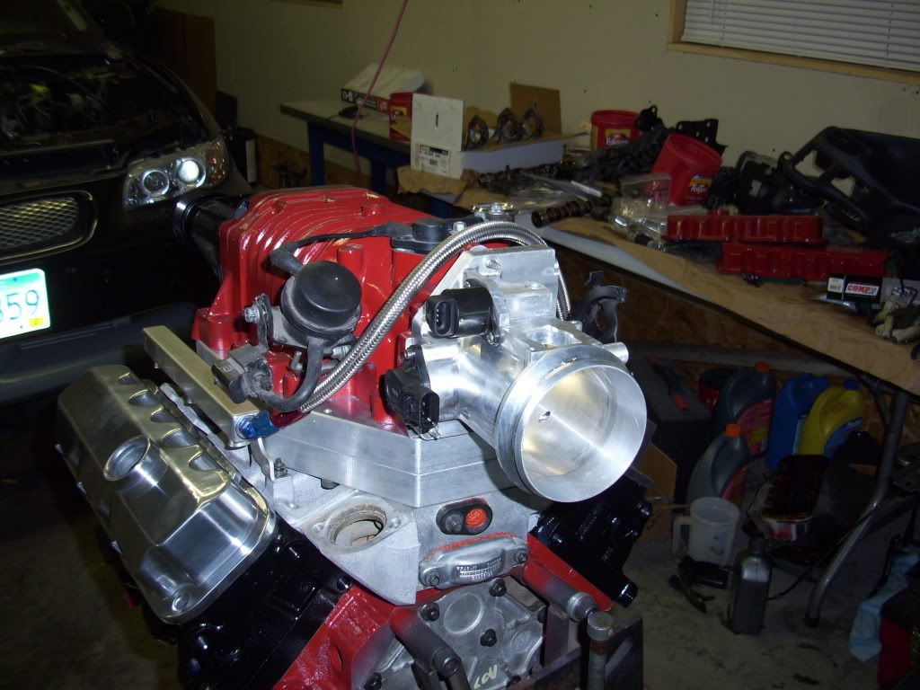

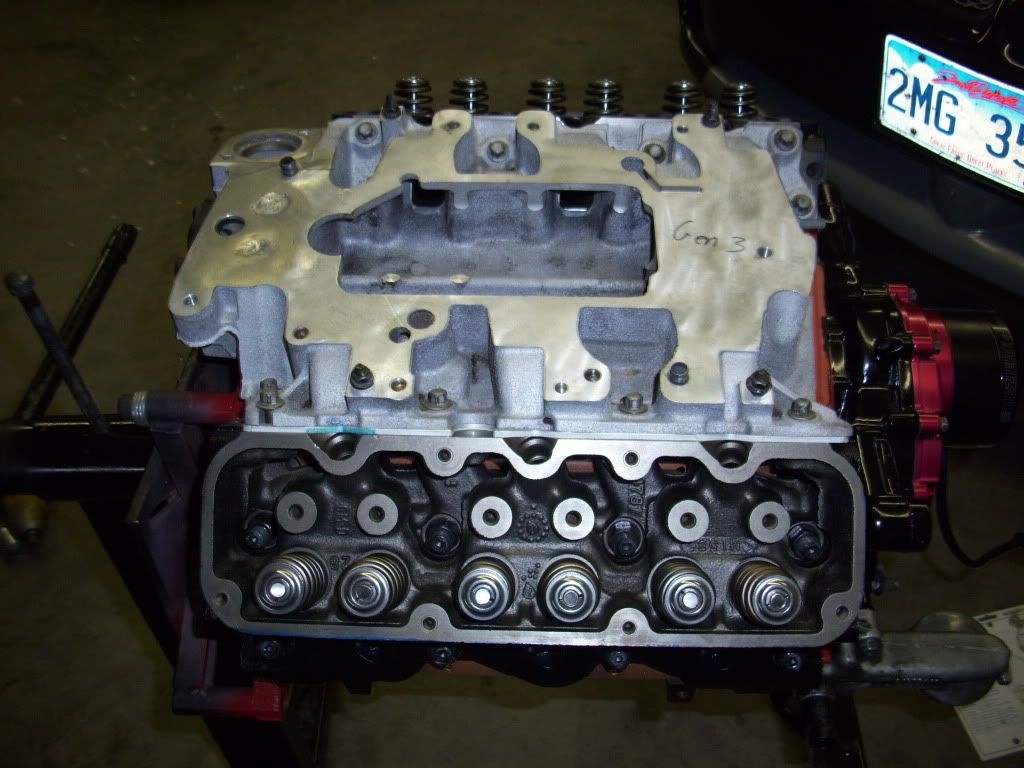

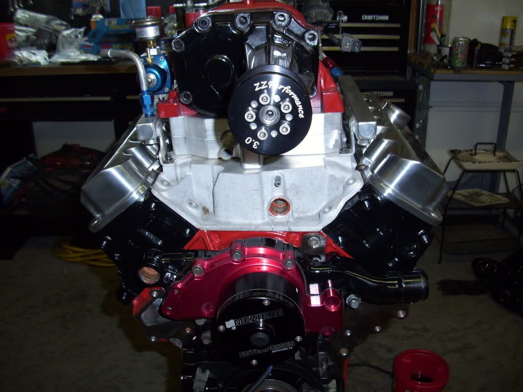

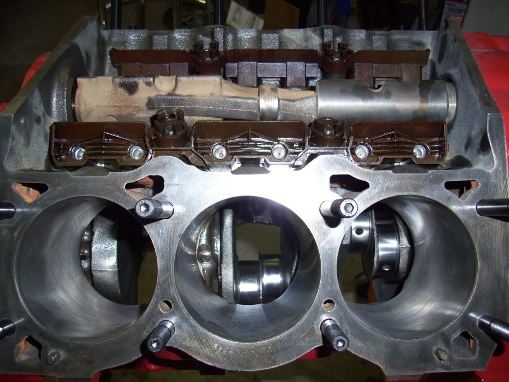

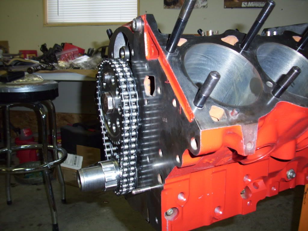

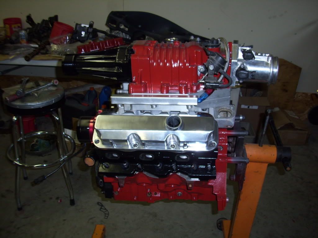

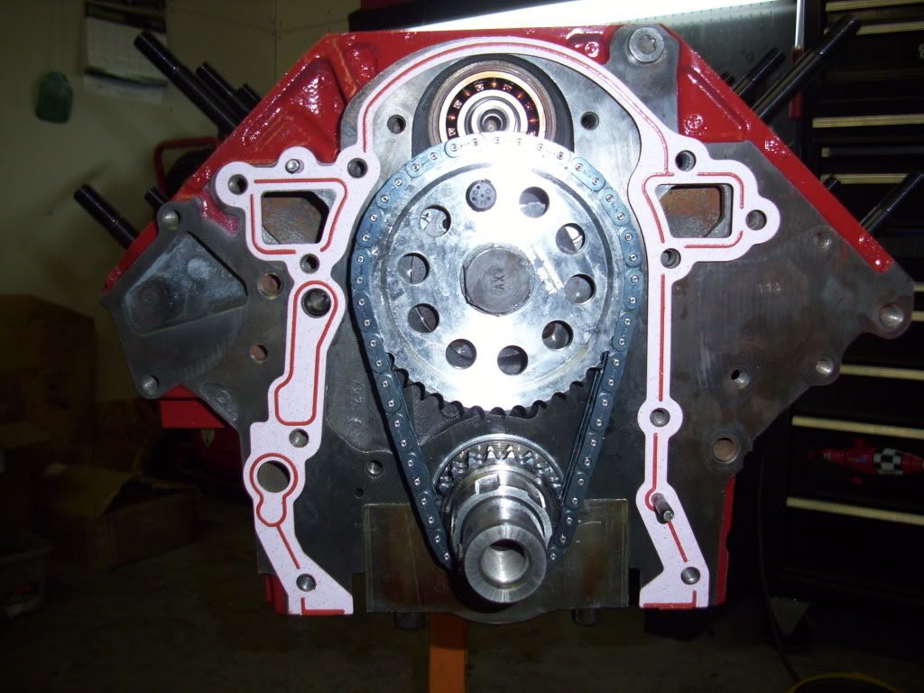

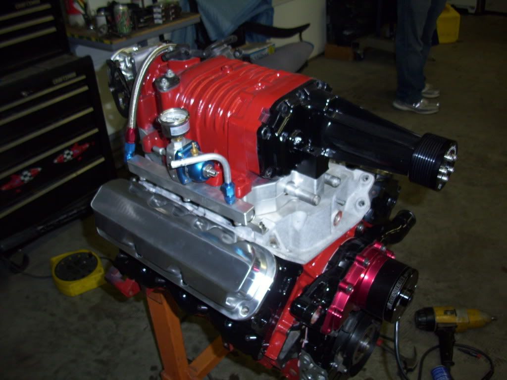

    Ok so i brought this thread back from the dead so let me get u guys(who care) up to date. After getting back from the ZZP trip me and my buddy took to get his turbo and tranny build setup, i ended up coming back with 2 sets of heads. ZZP CNC Heads and INTENSE S4 Heads that i sent back when i got back to South Dakota. heres the list of what i cam back with and what all i sent back:
    New Build:
    ZZP CNC Heads(105 springs on Exhaust, 130 springs on Intake)
    XPZ Cam
    ZZP Fuel Pump
    Fuel Pump Re-Wire
    ZZP 3.0 Pulley
    ZZP Aluminum Valve Covers
    ZZP Stainless Headers
    L67 Full Engine Gasket Kit
    Poly Motor Mounts
    ZZP 78mm Billet Throttle Body
    Stuff Sent Back:
    INTENSE S4 Cam
    INTENSE S4 Heads
    Also sold my Ported Gen III supercharger so i could get a Gen V supercharger that i am in the process of polishing. and now here come the best part, PICS!!! lol. Let me know what u guys think and give me your input whether it be good or bad. I know alot of u guys dont like ZZP mainly cause there PCM's are junk which in fact they actually owned up to.
    Im quite a ways farther on the polishing and what not with the blower than in that pic now but thats what i got as of right now. the pics with the IC and Gen III on were just mock up pics before i sold that.
