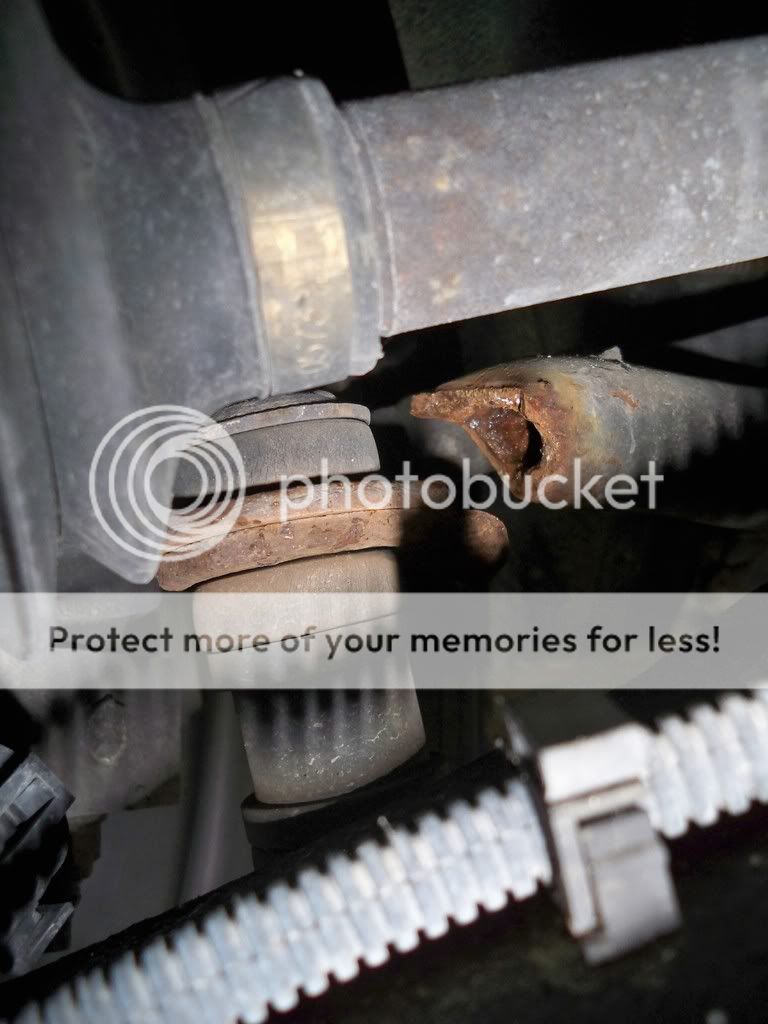

    I decided to take a look under the car today and I came across this:
    http://i366.photobucket.com/albums/o...y/100_1622.jpg
    I'm not sure what the broken part is...and would this be why my ABS & Traction control are not working??
    I'm going to take it to get ABS codes scanned but I wanted to show everyone the picture and see what feedback I can get.

    Looks like your front sway bar is broken, but no that wouldn't affect your ABS. Just affect your handling some.

    That is the sway bar. Looks like it has been broken for some time. No, it will not affect your ABS & Trac lights.
    Make sure you get that fixed.
