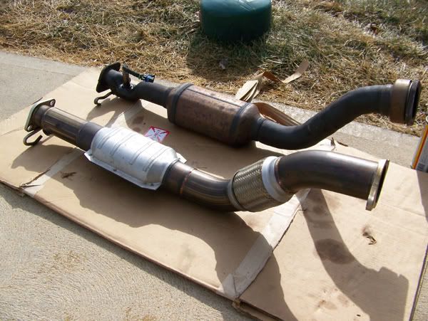

    Donating Users kfish's Avatar
    Ohio
    971
    check out a picture of one in the for sale section. im not sure i never really looked at mine. i took it off and shipped it back to zzp for cat credit
  11. #11 Re: Bad rear 02 sensor and random misfires. Can runs just fine.
    Feb 2008
    West Jordan, UT
    235
    That's what a stocker looks like. I was planning on hollowing it out from the rear, then I remembered that the ubend prevents me from doing so.
