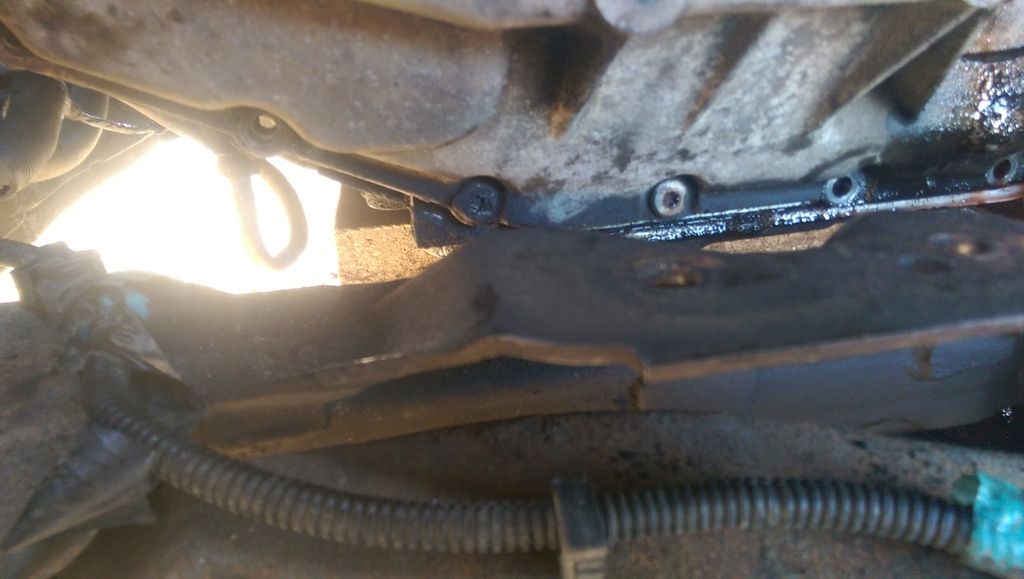

    So I bought a 99 GTP for $450 needed a solenoid in the Tranny I bought all the solenoids for a cheap deal figured save time down the road. I am deep into puking the side cover off the Tranny and I stripped 2 of the torx bolts they're behind the trans mount and no way to use a bolt extractor there any ideas suggestions tips. I'm completely stuck right now.

    The two bolts in the pic are the culprit they were a t40 torx bit tried an Allen had in there none fit also tried bigger t45 no go

    I have found a small chisel to put a groove in one side..then tapping in a counter clockwise fashion is often successful. You likely need to support the engine/trans better and lower the subframe further.

    What about dremeling out a line in it and using a big flat head?

    Chiseling ain't working its just busting the crap out of my chisel

    Use a metal chisel...not one for wood.
    You can dremel them and then they should come out decently with vice grips.

    It looks like I could fit a dremel with a small cutting wheel its getting dark so I gotta leave it for tonight now gonna be slowly dripping out all my trans fluid all night and all day tomorrow lol

    you may be able to get a right angle grinder in there, or a sawsall should get to them.

    I thought about a sawzall to but if I slip it'll go straight through the aluminum side cover and I tried angle grinder wheel is too big dremel should work with a small 1 inch blade

    First thing after work tomorrow gonna try bolt extractor I got the sub frame a little lower and the engine a little higher just enough to clear a straight shot with a drill bit

    id not use one of them just yet, try to get it out with out drilling it. if the cut slot dont work, or a metal chisel then as a last resort id drill and try an extractor.

    Okay I'll try the slot first hopefully I can get her out the whole job went super smooth til that happened
