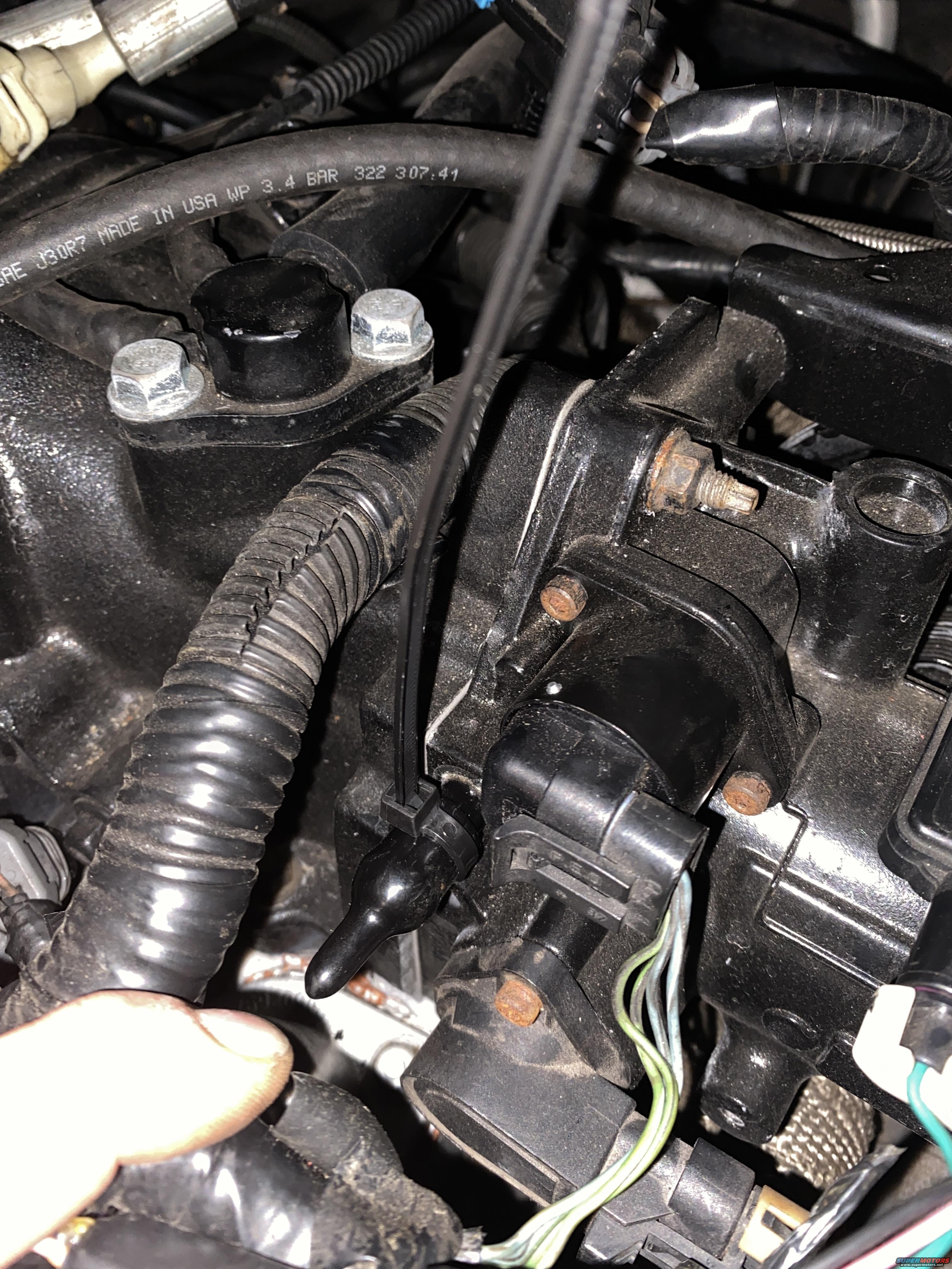

Welp... that didn't last long. Enjoyed the car for 5 days and back to having problems. I drove it last night, did some small pulls, made some turbo noises, and all the sudden car starts running like ****! I can hear the exhaust isn't right, running rough, wanting to die at red light, then surging, then wanting to die, then surging. When letting foot off gas pedal the engine stays at 1200-1500 RPM's, instead of settling to 900. GOD DAMN IT. Can't catch a break with this ****ing thing.
I'm thinking I have a huge vac leak somewhere. Most likely the brake booster, it's been suspect for a while now. That would explain the surging and RPM's not dropping.

Checked vacuum hoses, sensor connections, removed MAF, pulled front plugs. It ran better with MAF removed. Front plugs looked good. When hunched over doings spark plus, I notice this big ass hole in the throttle body. It's the vacuum tube going to the BOV when it had an M90 still. It was capped with a rubber nipple. The head of that nipple must of dry rotted and blew off during a turbo pull. LOL. Capped the hole with new pointy nipple.
All is well now. She's back up and running good. MakeAme soo Happy. At the same time I'm thinking.... Man I hate this car. Blown of nipple.... F YOU!!

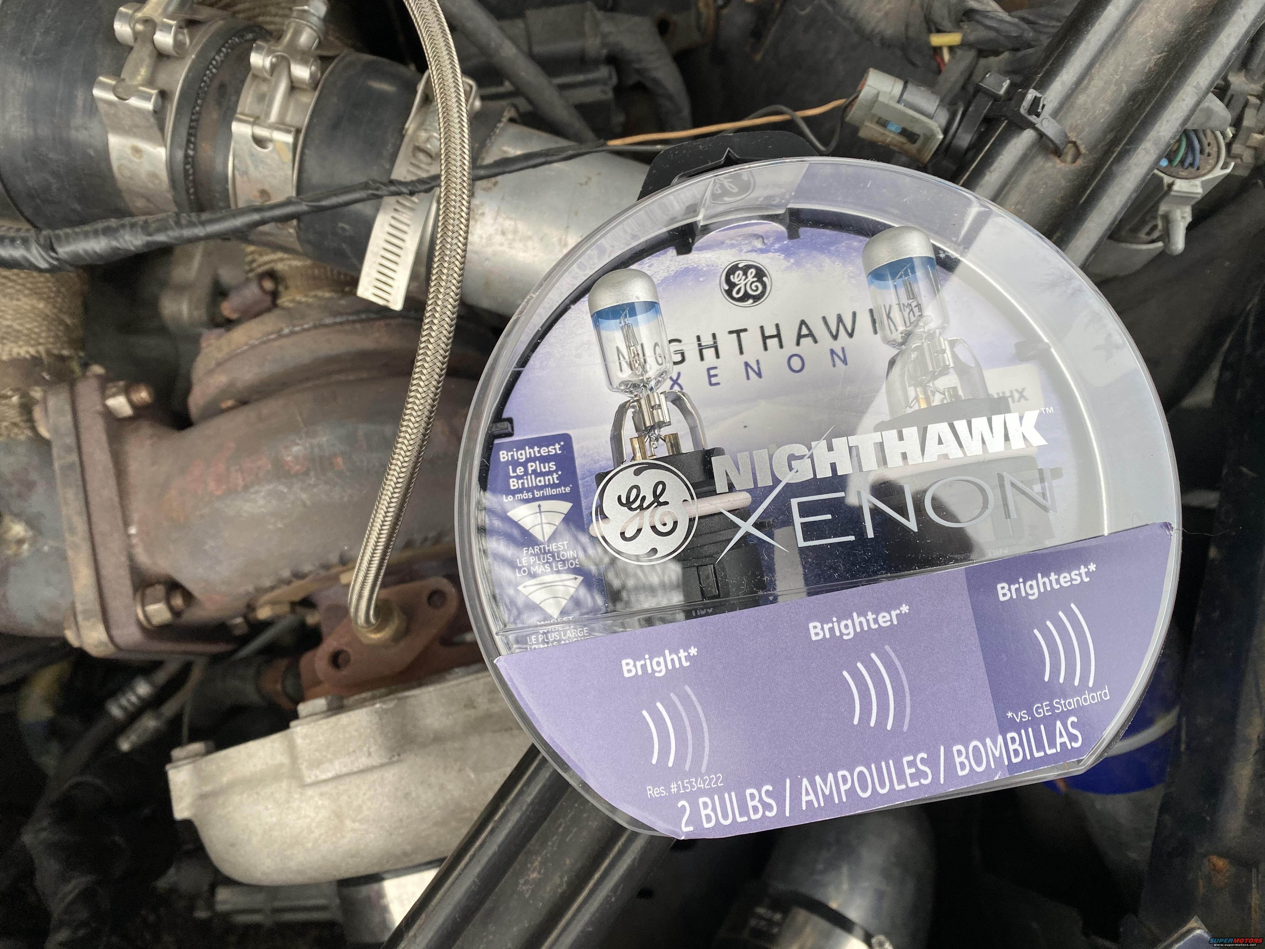

Put in brighter headlight bulbs

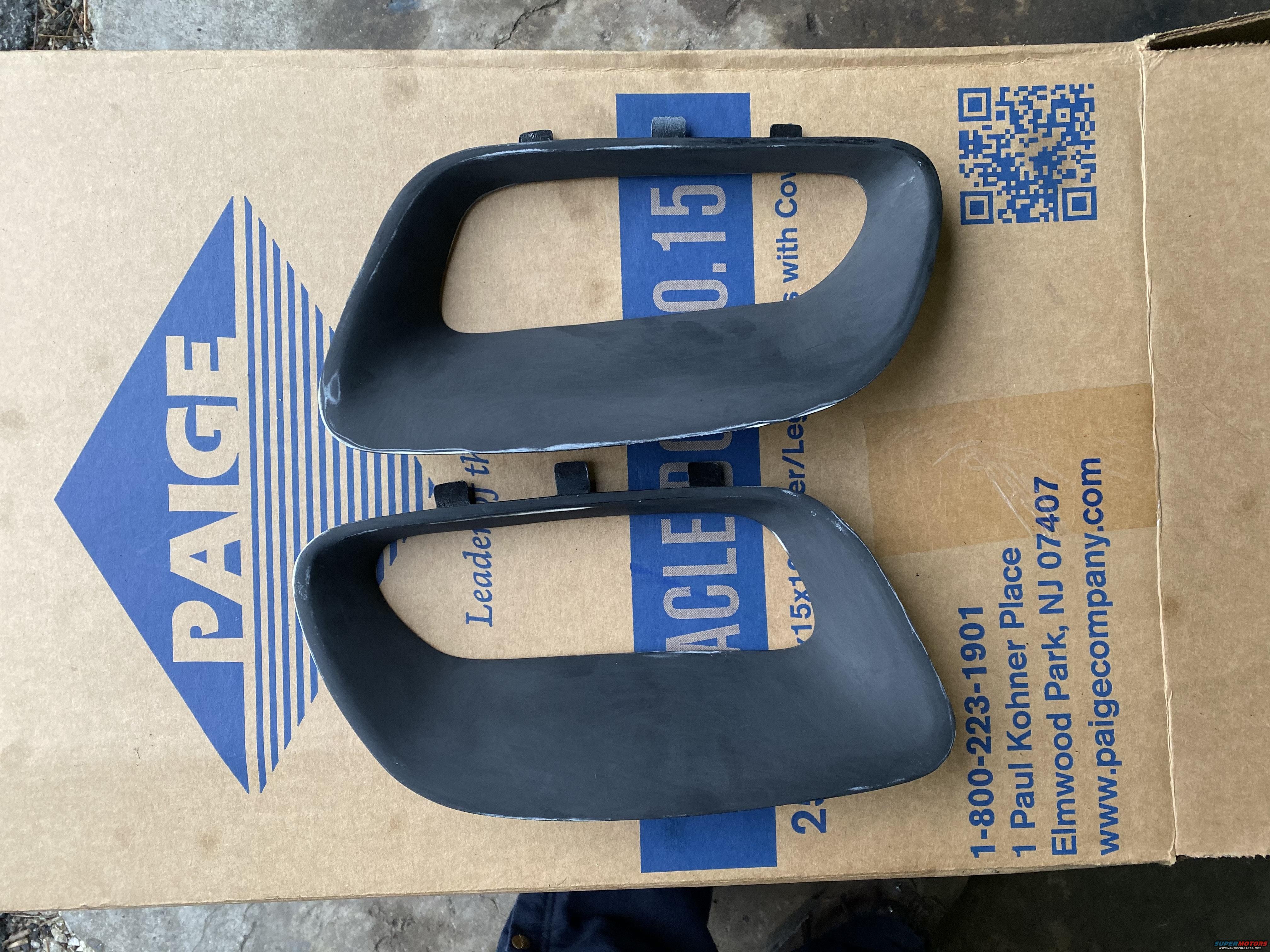

Sanded down the GPO's. Got them from PurpleGuy some 2yrs ago. I was told these GPO's were part of the original batch, made way back when.
Went to spray them... All my spray paint cans are broke. Apparently keeping them in the garage in sub-zero temps last winter changed the pressure or something. Nothing aquirts out. Sucks
Ordered new paint. Should be on my porch today.
https://www.supermotors.net/getfile/...02.-sanded.jpg

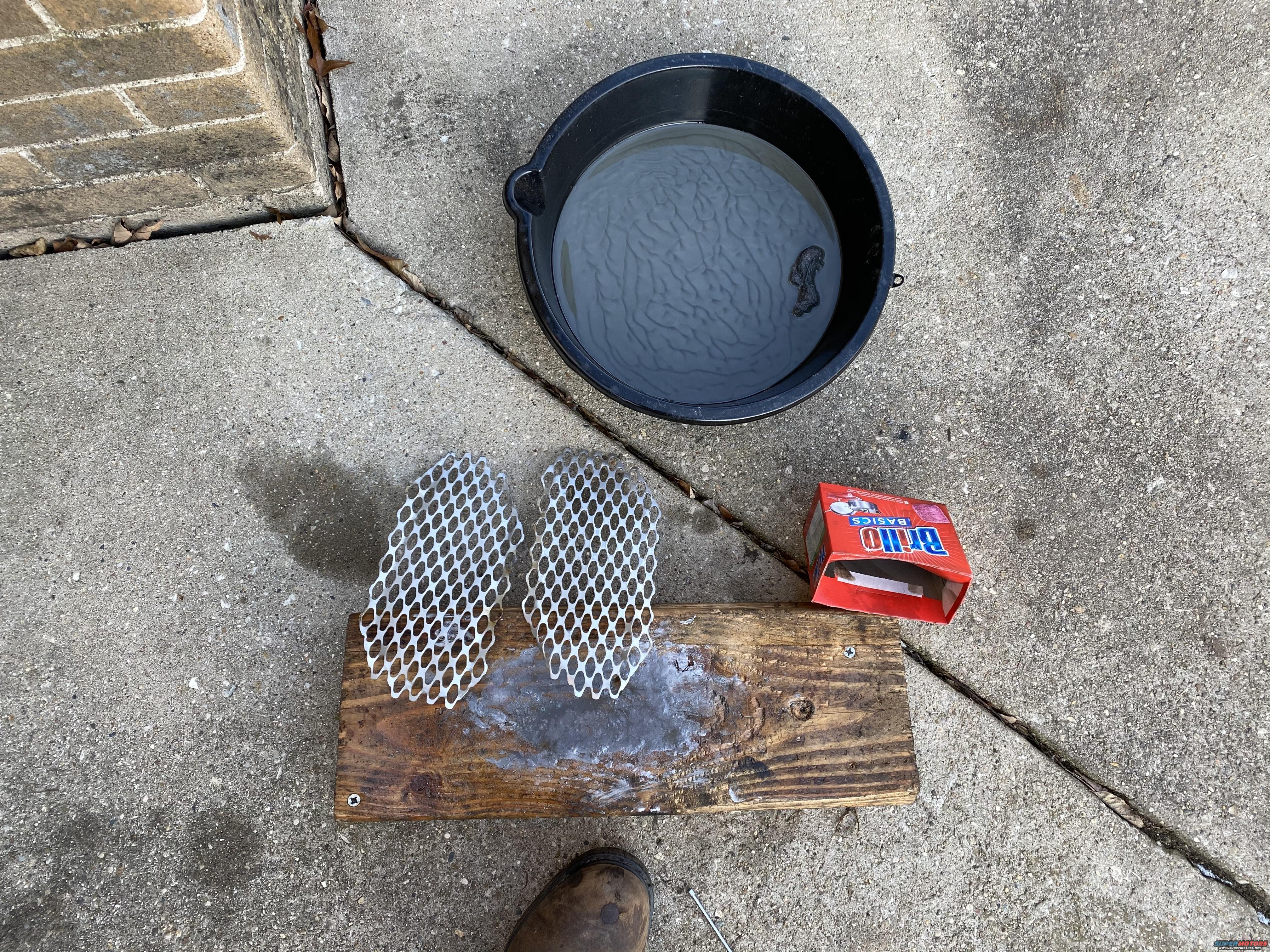

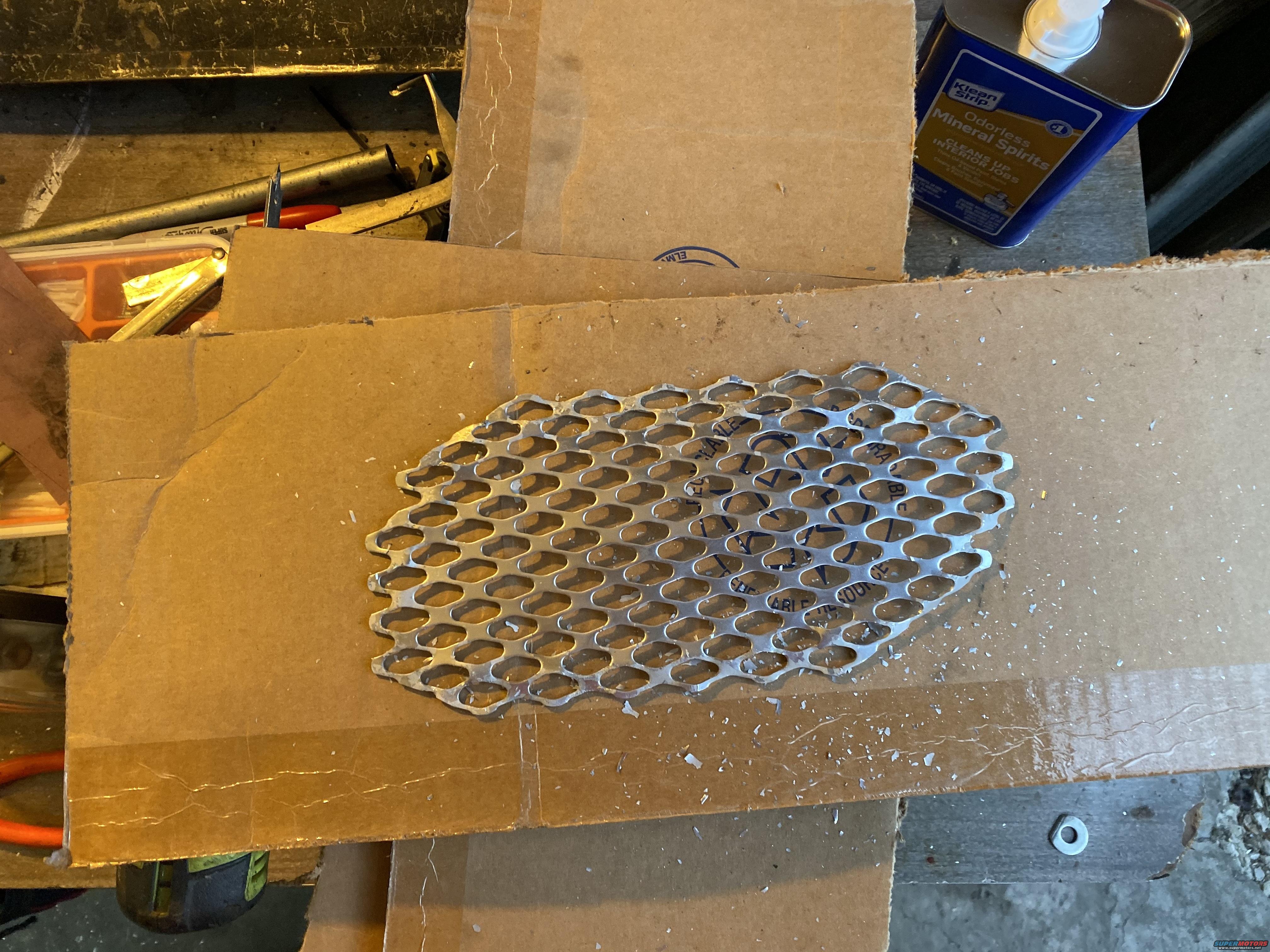

Went to get the metal mesh ready. Paint started flaking off like crazy. SMH. Another hurdle to getting these done. Soaked them in Pain Thinner and scrubbed them with a Brillo. Ready for fresh paint.
https://www.supermotors.net/getfile/...3.-flaking.jpg
https://www.supermotors.net/getfile/...nt-thinner.jpg

I would! And want to. Even with those brighter bulbs you can't see shyyt. But I'm still dealing with that voltage drop issue when hitting the brakes. Sometimes when the blinkers are ON, and I hit the brakes, the blinker will hyper-flash cuz the system thinks the bulb is out. I'm guessing the drain is causing this. I'm still thinking it's the brake booster at fault here. I will be sending the turbo to Bison Performance real soon, for a rebuild. When it's off, I plan of replacing the brake booster. And replace the engine mount....
But until that voltage issue is resolved, I'm not putting the HID's back in. They weren't liking that drop at all.
