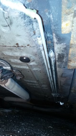

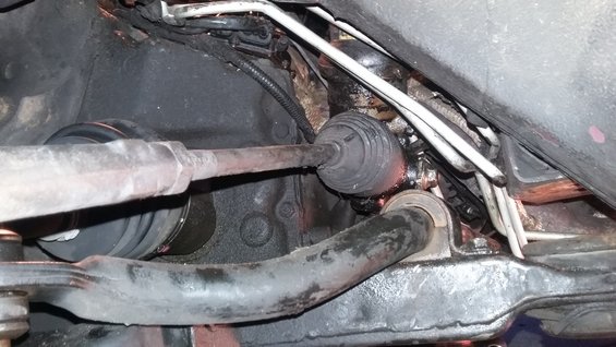

    New fuel lines are partially installed. The easy part is done, which was installing the straight lines under the car. Only thing I had to do was flip the fuel filter bracket so it would be more rear facing. Now, the hard part is getting these pre-bent ones up through the engine cradle, around the sway bar and tie rod. The way it’s looking now, I’m gonna be removing the sway bar and since the rack is leaking like crazy, might take that out as well. It should make the job easier and an opportunity to swap that rack out. Brake lines are next so I will need room for those as well.

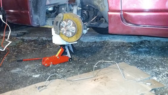

    Scotty,
    In your pic, in the post in the link below, did you loosen both the rear and front of the sub-frame to get it down that low? The rear bolts look completely detached, is that correct? Any other tips? Thanks!
    http://www.grandprixforums.net/threa...front-sway-bar

    just the rear bolts. but you dont want to drop it that far, take the two rear bolts out to the end of their threads, and lower the jack to them. let the jack hold the weight, not the bolts. this way you dont tear the shaft apart on the rack. you'll gain 2 or 3 inches of space to sneak the lines past.

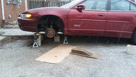

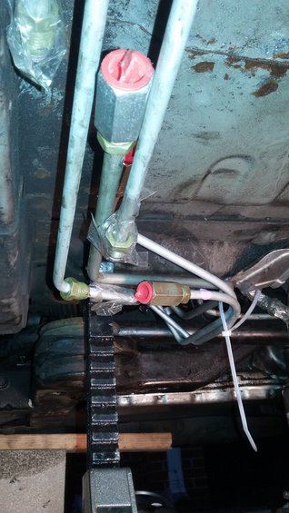

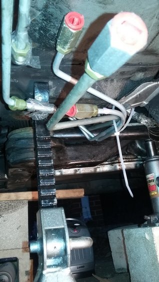

    Thanks for the tips Scotty. I was able to lower the sub-frame no problem once I had the correct tool. In this case it was a $16 bottle jack from HF. With the sub-frame lowered, I was able to needle in the second segment of fuel lines. Those extra 2-3 inches really made it soooo much easier.
    A little bit of snow:
    Fuel lines are staged and ready to be screwed together. Still need the brake lines, so keeping it loose for now:
    Close up:
    Sneaking up the fender wall… Look at that nasty, slobbering rack! It’s gotta go:

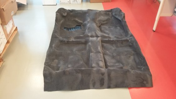

    Carpet came in today!
    From RockAuto. Specs are: Graphite, cut-pile, mass-backing. No plush for me. Saved some cash.

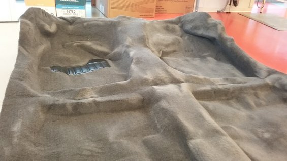

    Looks a little loose but I'll make it work:
    Close up:

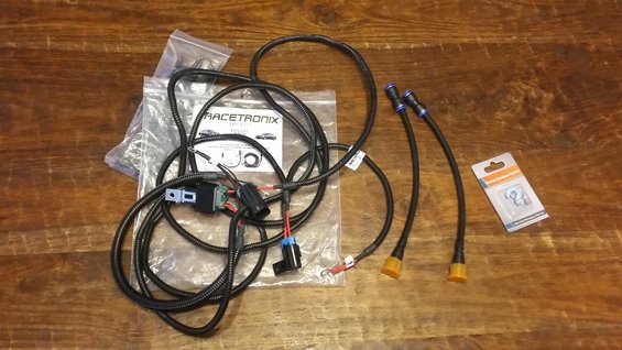

    Racetronix re-wire came in today. That stock fuel pump relay is a weak point on my GP. It failed on me before and the wiring was adjusted somehow. It worked, but the part of the wire that's inside the engine bay, by the battery, gets pretty hot. Glad to be getting a fix for that. Also got the nylon fix-kit for the fuel lines, and the disconnect tool. I used the Sharpie idea earlier in my posts, but for a few bucks I got the right tool.
    I want to run the Racetronix wires through the inside of the car, rather than the outside. It's been discussed on the forum in a few threads, but not definite answer. I want to run the wiring under the carpet and through the passenger side grommet. If I run the wires through the top of the fuel pump lid, will the lid still close? Will gas fumes be an issue? Has anyone done this? I'll find out for myself soon, but any pointers are appreciated.

    I took a big screwdriver and layed it where I was going to run the wire into the fuel pump area and smacked it with a hammer to make a little channel for the wire to go through.

    Quote Originally Posted by 01Blackgtp View Post
    Word. No issues with gas fumes or anything like that?

    No, its not like the tank is just open under that cover. There are bigger holes to the underside of the car in the bottom of the channel the back seat clips into.
    Edit: Your seats and carpets are out, look in those holes the back seat base clips into at about a 30 degree angle, you can see the ground through there.

    there should be no fumes, the canister should be sealed via the oring.
