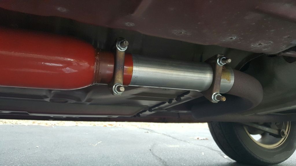

    my cat back was al slip joints, so i got a 32 inch glass pack, bought a flange cut the tube off one end and welded the flange on the gp.
    i still have this too. i got a new cat back and saved it, cause we all know the res likes to rot out.

    I shoved on and clamped this glass pack on a year ago, still on after a New England winter......

    See post #7430 in the "boat" section for more info.....

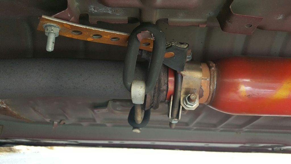

    I've been kindly instructed to order a new flange piece because mine looks so bad. Suppose it might be rough/rotted enough that it can't be cut and saved, I dunno.
    Apparently, the few days it would take to get here would be "too long," because running straight off the DP would be "too loud." Lol
    Here's what it is anyway -
    Dynomax/Walker 41806, and you'll need a couple bolts. That bolt length seems good. There's still enough room for a nut on the end.
